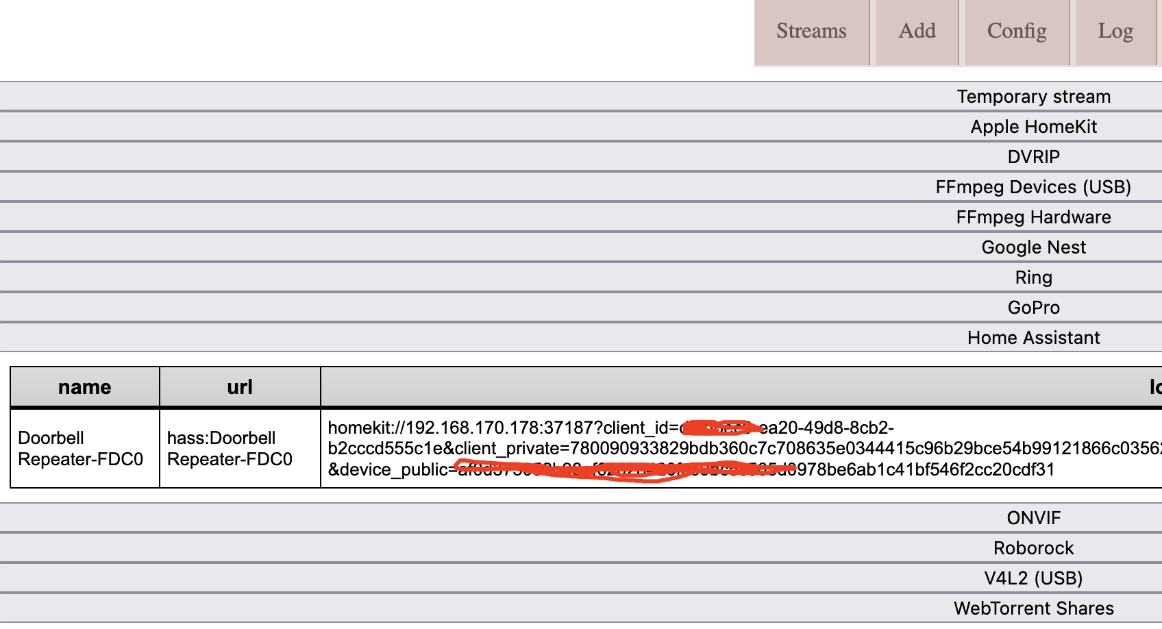

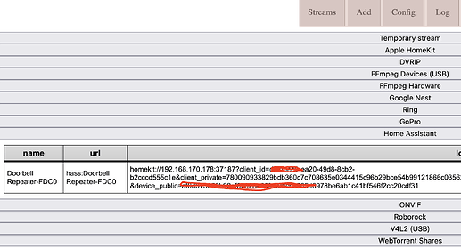

For step 5:
  • To make go2rtc list your Home Assistant entities, you need to mount a file from Home Assistant to go2rtc: "homeassistant-data/.storage/core.config_entries:/config/.storage/core.config_entries:ro" (homeassistant-data is my volume for the persistant data).
  • After adding this, go2rtc lists the doorbell paired with Home Assistant. Copy the location…
  • … and add it to:

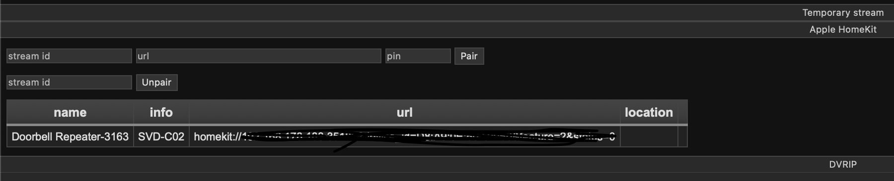

I have added the G4 to the Aqara app and removed it from Apple Home.
When I go to homeassistant via the HomeKit integration, I get the message ā€œno paired devicesā€
But in Aden go2rtc I get the following message:
How do I get on here?
