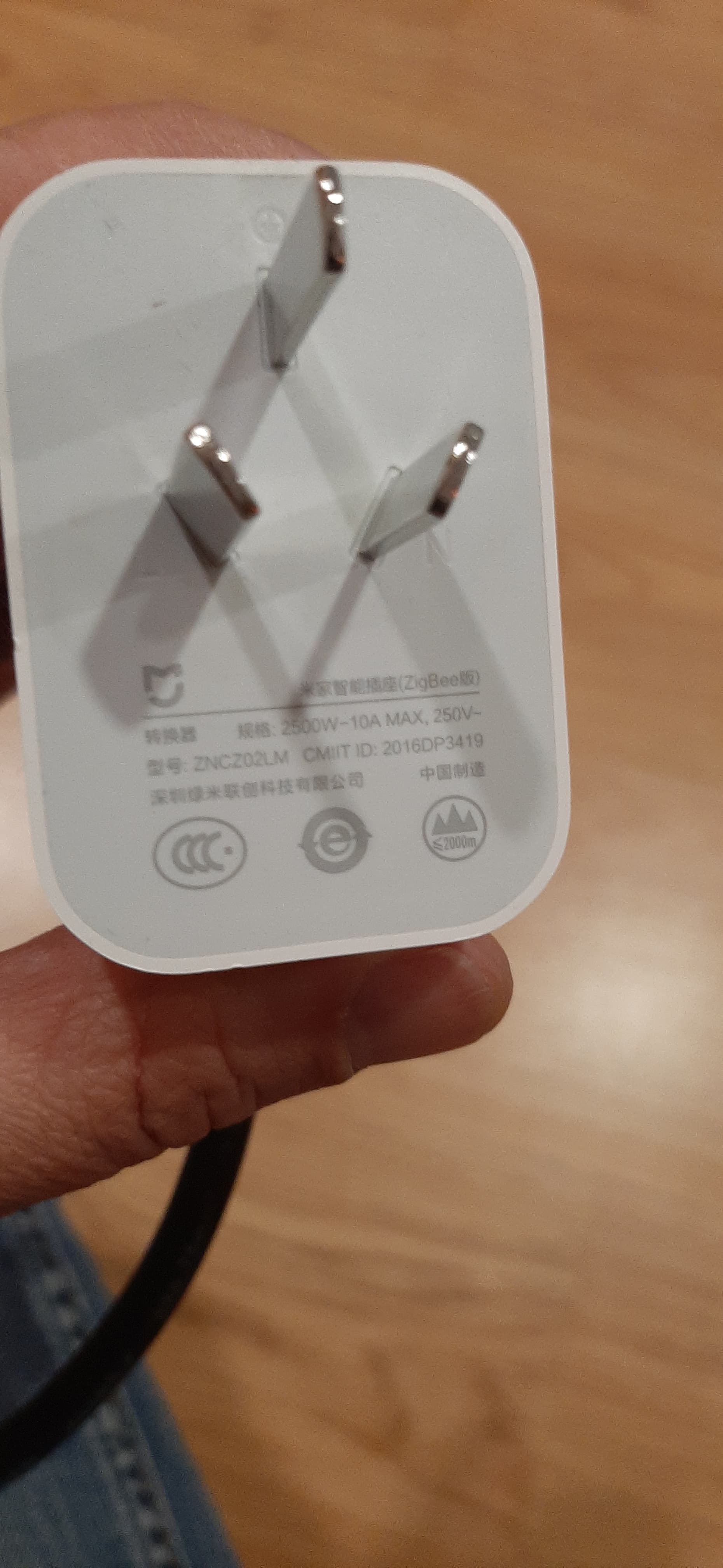

This is the plug:
Any ideas?

Are you sure it’s Zigbee? I have 4 that are Zigbee and 2 that are Wifi. The wifi ones don’t have power monitoring. Alternatively, have you confirmed the entities are enabled in the integration? Should be the case, but worth checking.

yes, the plug is zigbee

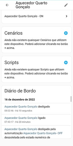

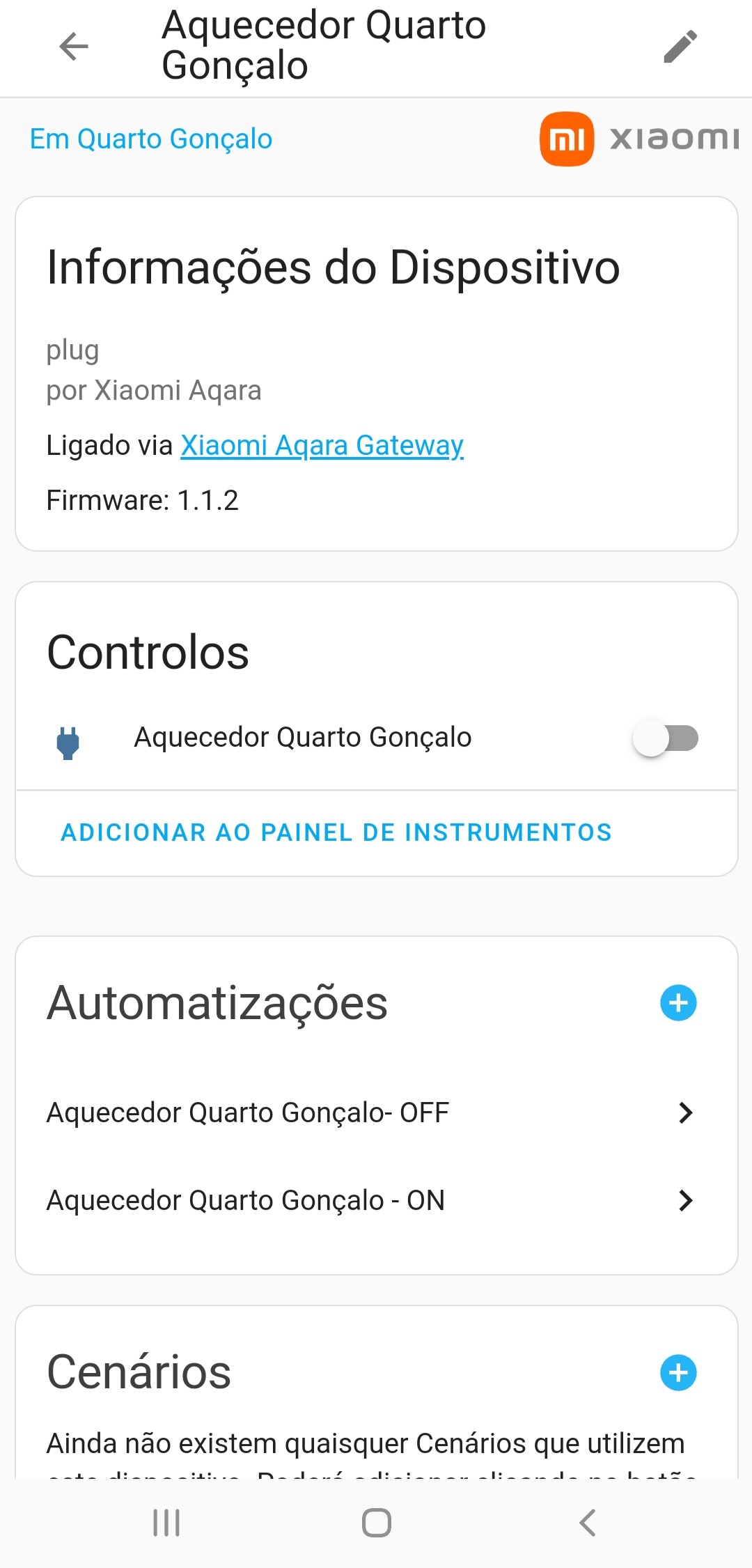

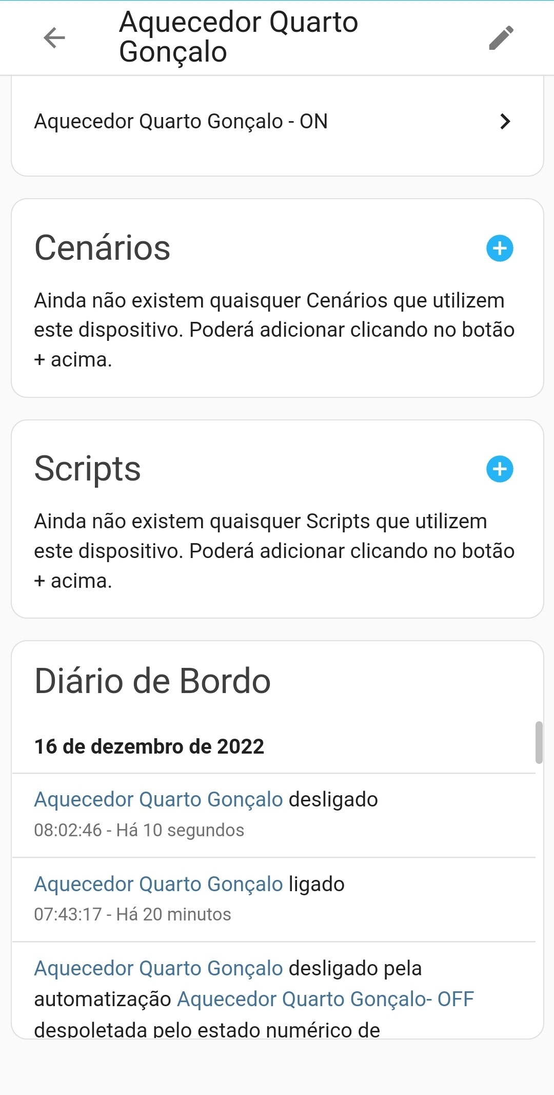

already checked the hub integration options and the device integratio . Please se below the screenshots:
The only other thing I can think of is to delete it and re-add. I’ve had issues with some Zigbee devices not showing up all entities, but I don’t think it was with the plugs. Worth a try though and maybe you’ll get lucky. I assume it does show the power in the Aqara app? And there’s nothing in the log? I use a different hub, so my situation is a bit different.
