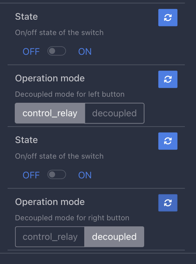

Yes, we have an Aqara ‘Smart wall switch H1 EU (with neutral, double rocker)’, WS-EUK04 set up like this. One switch controls the relay and one is decoupled. The Zigbee2MQTT controls look like this:
Thanks, that’s exactly what I needed.
