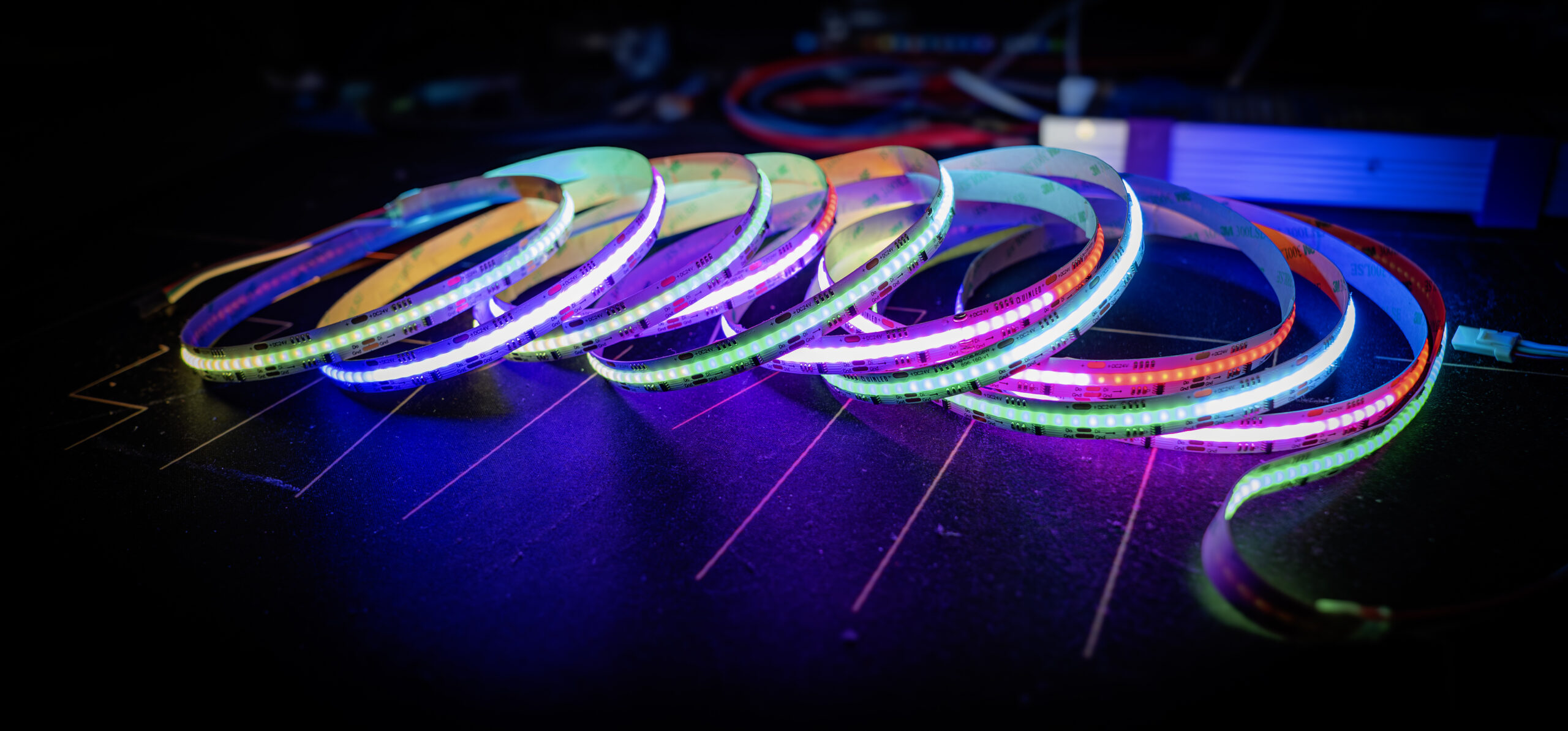

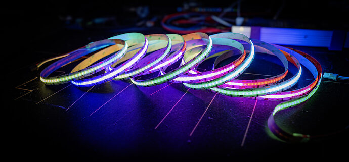

FCOB SPI RGBW WS2814 IC LED Strip Light 784LED/M Addressable Dream Col – BTF-LIGHTING

FCOB SPI RGBW IC WS2814 SK6812 768 LED Addressable Dream Color LED Str – BTF-LIGHTING
