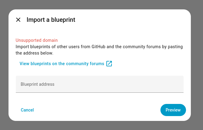

I am trying to import it to my instance but I’m getting “Unsupported domain” error. Does it make any sense to you ?
I tried copy-pasting the actual code into a yaml file in the blueprints folder but I must not be doing it right.

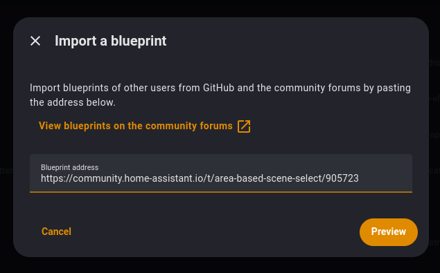

Did the “Import Blueprint to MyHome” button in the first post not work?
Where are you seeing the “Unsupported domain” error? If this error is showing up in an editor like Visual Studio Code you can ignore it, the syntax extension it is using is quite a bit behind and the errors it produces are false positives more often then not.
The button itself does what it’s supposed to do i.e. prefill the popup but then I get
NB: I am able to import using that same popup when it’s from github…
I don’t really know what to tell you, I just tried it and it worked as expected…
Why isn’t the blueprint address shown in your screenshot?
What HA release are you running?
If you can’t get the MyHome link to work properly, you should be able to add it manually. I’m not completely sure if it’s required, but I think you’ll need to make sure that you use the expected directory structure:
config/blueprints/template/Didgeridrew/area-based-scene-select.yaml
Don’t forget to restart HA after adding it.
Perhaps they don’t have default_config: loaded and the template integration is not there?
Not sure I’ve seen that, but it might be possible…
Thanks for checking.
Yes the blueprint address shows at first but then when I click ‘Preview’ I get the screenshot I shared above. Running latest version of everything.
