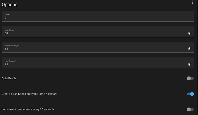

And here my settings:

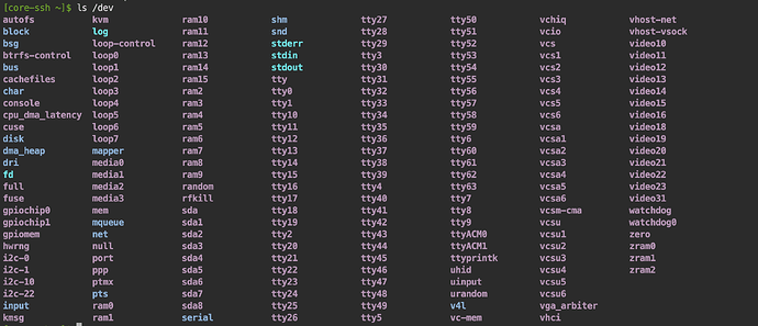

However, I can clearly see the buses:
And the I2c Configurator logs shows:
/dev/i2c-1
/dev/i2c-0 /dev/i2c-1 /dev/i2c-10 /dev/i2c-22
Found i2c access!  Nothing to do!  You can remove this add-on.
As I said, this suddenly happened. The case and fan worked fine up until yesterday. What do I do?
It looks like you have I²C Access. But I think there’s nothing on the i2c bus to communicate with. This may be a hardware failure. Or it could be something disconnected.
