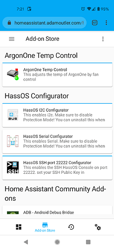

This case uses the built-in raspberry pi i2c bus. You have to enable the i2c bus before using it. I made some tools if you’d like to try them. I’ll create a thread soon.

I’m using different ones and it seems to work great on several RPis. [Add-on] HassOS I2C Configurator

No need to add additional mods
That is very old info. It should be working fine with the addon I mentioned above.
