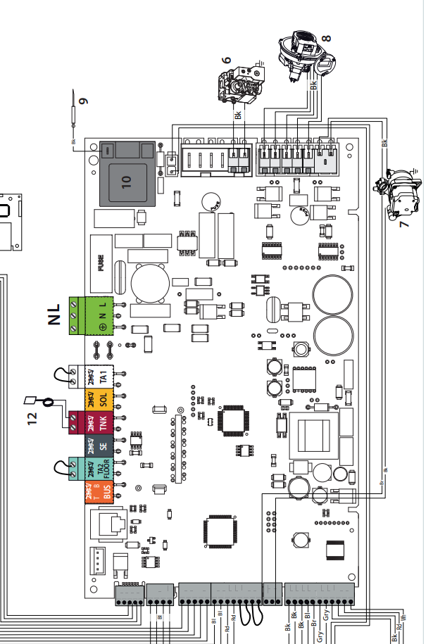

My boiler has these connectors and my questions are:
Does the HA eBusd integration replace the Cube S Net thermostat?
Is there any simpler way to do this? It seems really complicated with an ESP module talking via mqtt to a daemon that then talks to Home Assistant - can’t it be done directly via ESPHome?
Do I really need any of this to just get CH temperature adjustment and not buy the stupid expensive thermostat that is probably just something like a BMP280 with an MCU talking via their proprietary protocol?

It did not replace the thermostat ad the Cube, the adapter can be connected, in parallel, on the same bus port.
The Cube has 4 main functions: configuring the boiler, displayng diagnostics and statistics, managing the setpoint and relative schedules and lastly is a room temp probe.
With the adapter/ebusd you may be able to do the first 2 functions and a little of the third.This requires that a funcioning CSV is either already developed or you create it by reverse engineer the messagss.
If you’re able to build the PCB and write the code, why not?
ATM, for the info I have, there are no other cloud free alternatives. Even the new adapter from ebusd.eu that has a light version of ebusd and MQTT client on board is not able to accept custom CSV so that rules out all Ariston Group devices.

The adapter apart from the ESP chip has the circuitry to octo-decouple the bus signal (±24v) to vcc levels, if you connect an ESP uart to the bus you’ll fry the MCU.
So you need an adapter, for the bucks it costs I’d go for the adapter already complete and functioning.

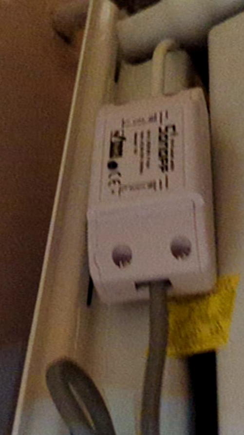

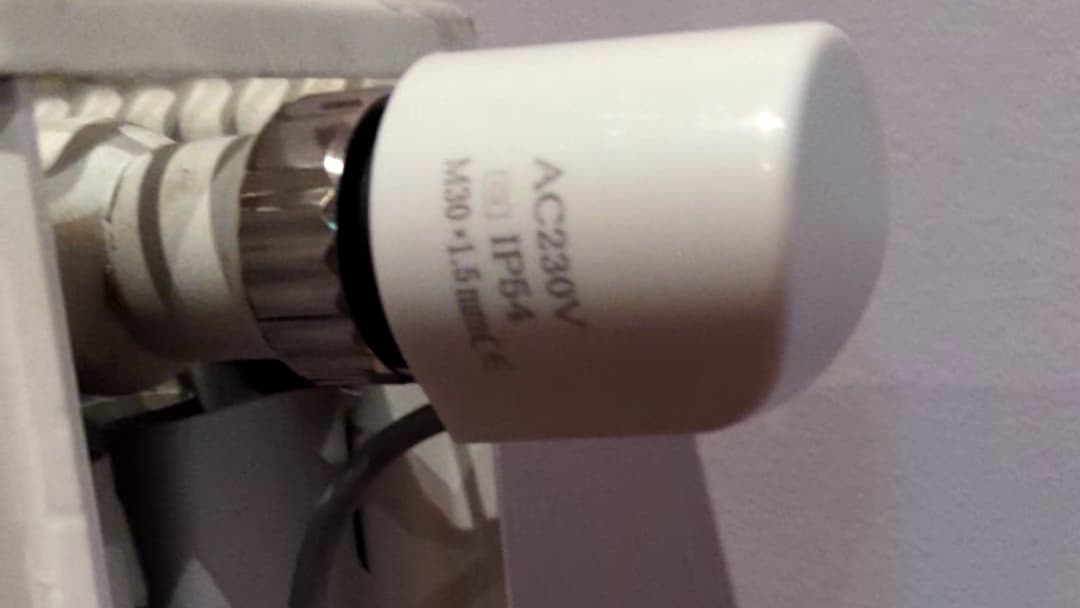

I decided to go with the TRV approach at first, as it seemed easier and cheaper. Before setting this up in my entire house I did it in one room with one radiator only. I bought some cheap 230V NO TRVs from AliExpress and wired those up to a Sonoff Basic flashed with ESPHome.
The second part of the system is a temperature sensor. I haven’t gotten around to making my all-in-one room sensor yet so for now I just have an ESP32 with an SHT31 in the corner of the room. Then I used the ESPHome thermostat component on the sonoff as you see in the code below:

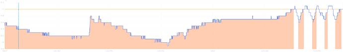

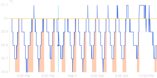

I found these settings work pretty well and the temperatre fluctuation is tolerable

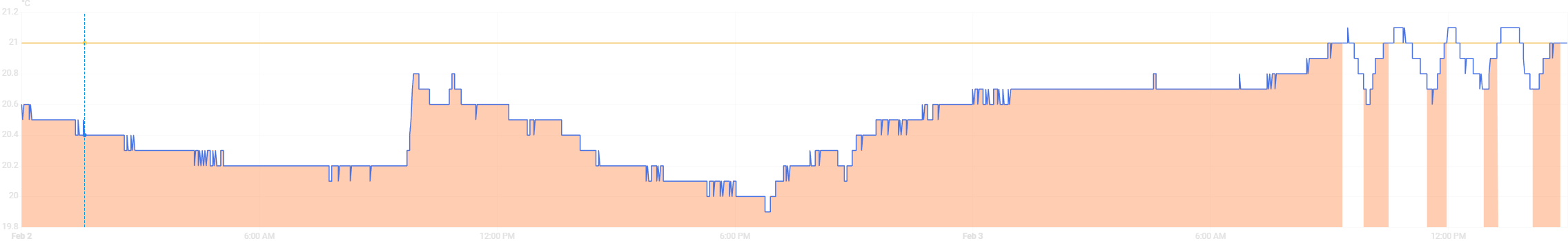

Overall, I’m pretty happy with this solution, however there are still some edgecases in which it’s not enough. For, example when the temperature is too low outside it is not able to maintain the target temperature with CH Water temp set to 45°C.
When I manually increase the CH temp to 50°C it goes back to normal, however automating that with eBus is something I want to set up in the future.

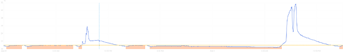

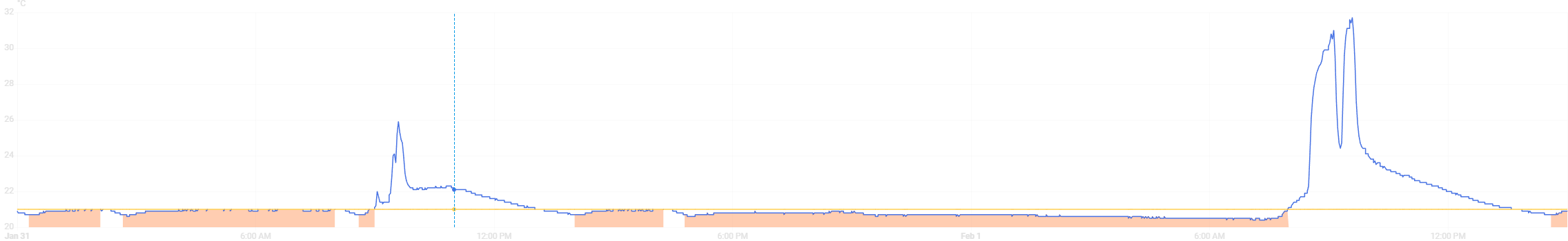

Another issue I’m facing which I can’t fully explain is temperature spikes which happen on the SHT31 every two weeks or so for a couple of days. At specific times the temperature spikes to 26°C or more which I doubt is a reliable reading
