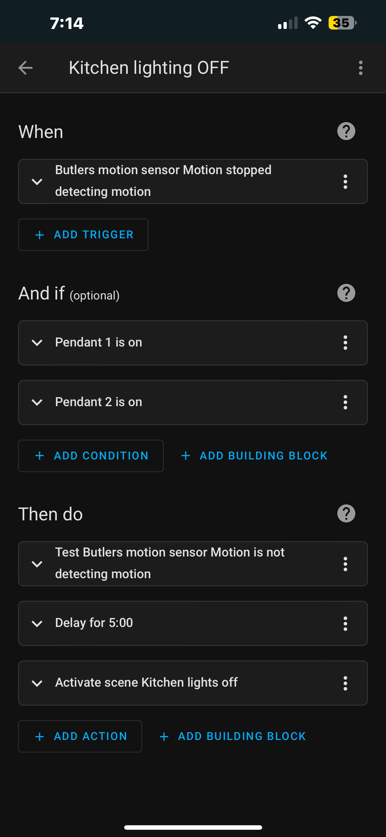

I have been tinkering to with my pendant lights in my kitchen.
I would like them to turn them selves off after my motion sensor does not detect motion after 5 minutes.
Do I have the below automation correct?
I am finding the still want to randomly turn off even with a presence in the area.
