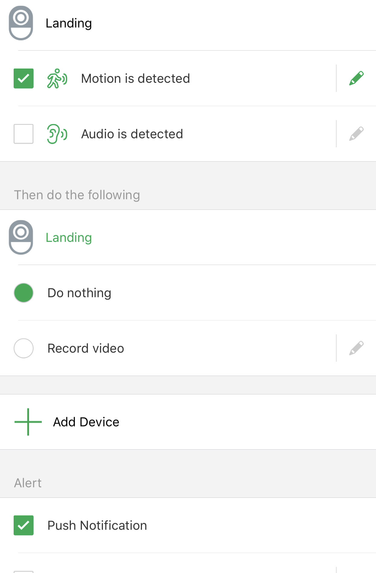

7 days later it used only 3% of my battery
Thanks man - can you please specify how you’ve set you mode policy and let me know where your cameras are located? I have mine indoors and have audio/motion enabled and I think they deflated in a week easily …
I have the Arlo Pro set at about 6 meters from the base.
i use home mode with only motion detection on when at home and armed with only motion detection and video record when away. No sound detection at all
thanks that clarifies something - as I had record video on as well … so you policy looks like this per camera?
Indeed yes only difference i send notification to email
thanks perfect - will give it a try - if that works I may be able to retire some of my motion sensors …
