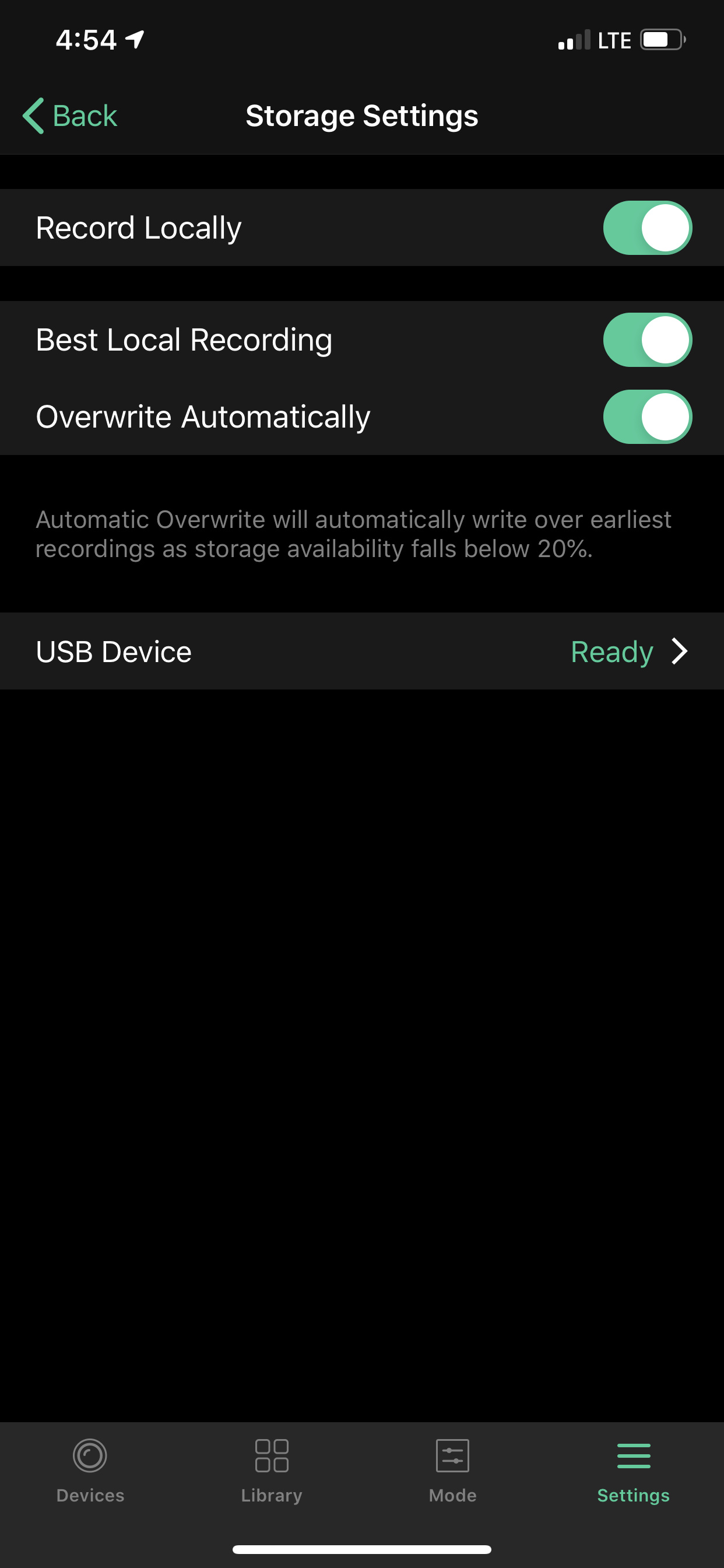

I’ve tried to achieve the same thing and am now stuck with the exact same problem: Old images delivered when motion occurs
Any updates on your side on this?
Unfortunately same issue. I was just thinking today maybe this is related to having the Local storage option enabled in Arlo? Do you have That enabled as well? I was planning on disabling and seeing if that makes a difference. I’m attaching my config in Arlo.
Seems not to cause the issue for me at least, since I have no USB device connected and this setting is therefore disabled in my setup.

I’ve turned off the local storage option with no success as well.
