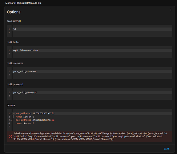

Yes it was your solution i was looking at thanks. This is the error i get when trying to save the config even without any changes:
The error states a problem with the option “scan_interval:”, not your array.
I suggest to edit the config as yaml (three dots in the right top corner, “Edit in YAML”. You might have an issue with some irrelevant formatting, spaces or something like that.
Feel free to post a screenshot from the raw yaml.
Oh yes !
Its an int in the schema:
ignore the 30.0 bit - it is 30 by default and that has the same issue.n
I think I found the issue, you have to change your schema in the config.yaml:
schema:
scan_interval: int
mqtt_broker: str
mqtt_username: str
mqtt_password: password
devices:
- mac_address: str
The data type directly follows the variable name, not sure where the “type…” is coming from for your schema. See this documentation: Add-on configuration | Home Assistant Developer Docs
I also suggest to have a look at the more advanced data types there. I already suggested the “password” type, but think that you should also introduce minimums like scan_interval: int(1,60) and url for the mqtt broker and a match() with a proper REGEX for Mac-Addresses.
