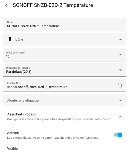

FYI, it is this one: SNZB-02D - SONOFF Official
I thought it was pretty popular and quite common to query those kind of devices with HA! :grin:
