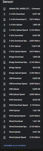

Here it is:
Versione firmware:[3.0.0.4.388_23756]
I activated all sensors:
Except for the following, but only because none of the hidden entities seem not to get the download/upload speed:
My Asus is supported, it is a DSL-AX82U model
I think it’s the WAN Download/Upload Speed you need to “compare” against
If You click on i.e WAN Download Speed, you can change the “Unit Of Measurement” to “align” with Your Routers Meassurement
I.e Kbps ( kbp/s in HA )
