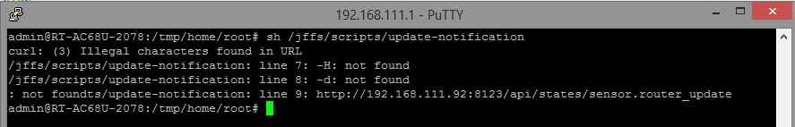

I get this:
In putty.
Got this in winscp:
I guess i have to get down to the “root” of the asus to dun the script, but i dont seem to be able to get u
out of the /tmp/home/root# folder?
Sorry, should be
/jffs/scripts/update-notification
Same result:

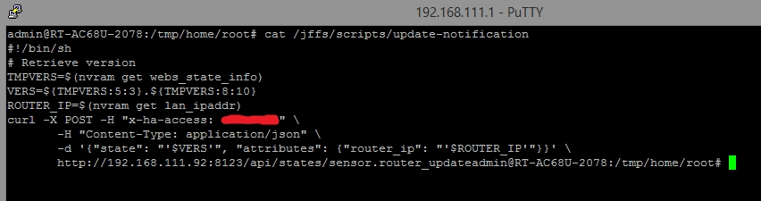

Could You show me
cat /jffs/scripts/update-notification
Here it is.
I added a linebreak at the end of the script.
Will wait and see if that made ant diffrence.
If i run this, sh /jffs/scripts/update-notification i get some sort of result:
