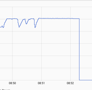

while the update frequency of the power/energy sensors is now usually 1 per second, when the projector turns off, it is noticeably longer. See the power graph here:
It was updating every second all the time (including when it started earlier), but when the projector was turned off, there is no update for 11 seconds. Sometimes this is a little shorter I think, but always at least several seconds.
Is this just the beauty of the device, that for whatever reason it struggles to keep up when power suddenly goes down, or something wrong with my config, anything I could do to speed up the detection of the projector powering down?

I don’t think this is it, because it is only sending the first 0 W value 11 seconds after the last ~220 W value. I’m ok with it not resending the 0 W after it sent it once. (reposting as I clicked the wrong reply button)

Alright, there’s something in the debug logs indeed when this happens.
(note the initial power is different here than in my previous screenshots, as I connected the plug to a phone charger now for a quicker test, but same behaviour happened).

I don’t see on your logs when you turn off the power. First line is 13:34:22, last line with some power is 13:34:23, one second later.
I’m not familiar with cse7766 component, but sounds weird it’s telling that reactive power can’t be negative. It’s negative for capacitive loads and positive for inductive loads…
The problem I have is when the device connected to the smart plug turns off. It’s not about the smart plug turning off, therefore naturally there’s no explicit turning off in the logs.
In this test, I used a phone charger and simply physically unplugged it. The power sensor was being updated every second all the time until 13:34:23, then there are no updates until 13:34:40. So I’m quite positive that I unplugged the device somewhere around 13:34:23.
If you need me to be more precise, I can try again, but it’s a bit hard to look at the log that’s speeding while I’m unplugging the device :smiley:
Looking at the logs, I’m wondering if maybe I should use apparent power instead of power, as that seems to be updated properly. I had that sensor disabled in HA, so I wasn’t aware. I tried this now and indeed I can see the apparent power sensor going down almost immediately after I unplug the device from the plug, while power freezes for several seconds.
Ok got it.
But esphome seems to report just normally the 0 power from 13:34:24. I don’t see the problem here.
No it doesn’t. Last ‘Power’ report at 13:34:24 is 46.5 W. Then there’s no update to the power until 13:34:40.
I see…
I was following just current reading.
So the negative reactive power puts cse7766 in tilt, I don’t think I can offer solution for that here. Follow the behaviour and report for bug.
Following apparent power doesn’t make sense, it can be twice the real power.
Alright, thanks.
For my use case it doesn’t matter what’s the actual power value, I’m only tracking whether the device turned on or off.
Follow the current then!
Should work too. That’s actually interesting, checking the full logs again, I can see that current (and apparent power) react to the initial turning on the load whole 2 seconds later than the power sensor. They are not frozen, just reporting 0s, when the power sensor already started reporting some power. Alright, so I guess I’ll use power for turning on tracking and current for turning off.
I see the component has room for improvement…
I have some Athom V2 plugs and they are functioning as I would expect. With the log running I see regular updates at my 10s interval with the lamp off, then on, then off again. On the history graph only state changes are recorded during lamp on when the power has slight fluctuations. I haven’t looked at this code for some time. I see that I have applied a fix for CSE7766 issues, I use “update_interval” instead of “sensor_update_interval”, and filtering the power for low draw to zero.
Not sure if this helps with your issue.
