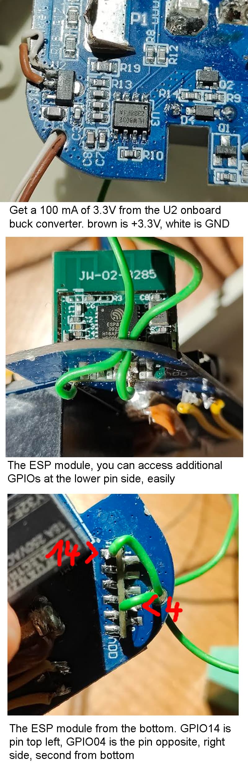

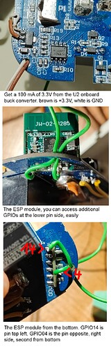

Last, but not least, I love these plugs because I can EXTEND them!! There are two quite easily accessible GPIOs that can be used for additional relays or sensors:
Free to use:
GPIO14
GPIO04
+3.3V and GND to power small devices (3V relay works) you can directly access from the buck converter chip at U2.
I am using this setup to attach another 3V relay module (1€) and a water leak sensor. I am using a new case, since you can’t stuff this in the old case. But I do not need any power supply and the cse7766 power monitor chip gives me loads of info about the state of the attached device.
