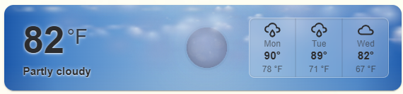

Thanks for this card, this is in my opinion the best looking weather card, I love the graphics and animations! Although has gotten quite an ordeal to configure (probably necessary for how configurable it is!)
Is it possible to add another chip next to the one of the bottom left? Like if I want to a sunup and sundown time chips next to it, is that possible? I can't figure it out unless i hard code the position, but the weather text may be different lengths depending on the text.
Also it seems like the unit_format option isn't applying to the minimum temp line in the forecast chip.

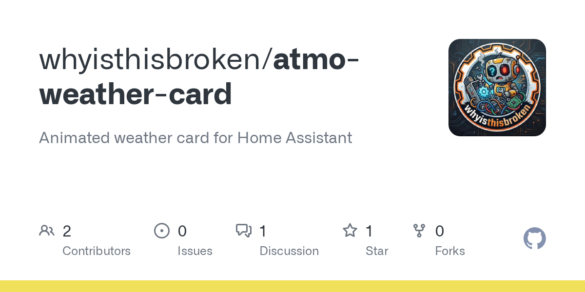

I've made a backup \ fork of his fantastic work.
Hope it's okay if I share this.
I also think it's sad that this project has been discontinued, but you also have to accept the reason behind it. I wish him all the best and really hope that he might start this project again. It was the best weather card in a long time.
GitHub - whyisthisbroken/atmo-weather-card: Animated weather card for Home Assistant · GitHub

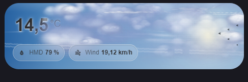

I’ve downloaded Atmo Card via HACS, and it shows up fine in my dashboard, but it doesn’t seem to be picking up the weather entity properly and is just showing NaN or N/A. Does anyone know why this might be? I can’t see any errors in the Log and all my other weather cards (Hourly Weather, Clock Weather) work fine with the same weather entity. Thanks in advance.
type: custom:atmo-weather-card
weather_entity: weather.openweather
sun_entity: sun.sun
moon_phase_entity: sensor.moon_phase
theme_entity: sun.sun
card_style: standalone
card_height: 130
card_padding: 16px
celestial_size: 50px
celestial_position: fixed
celestial_alignment: right
celestial_x: 45
celestial_y: center
chip_area_position: bottom-left
chip_text_size: 12px
chip_padding: 6px 10px
chip_gap: 8px
chip_area_background: true
perf_mode: ultra
perf_fps: 60
animation_speed: 0.3
bird_animation_speed: 1
star_animation_speed: 1
perf_cloud_quality: 2
perf_effects: 2
perf_fauna: 2
perf_dpr: 2
fauna_bird_density: 1.5
fauna_plane_density: 1.5
fauna_bird_flock_size: 12
fauna_birds_at_night: false
chips:
  - entity: weather.openweathermap
    attribute: temperature
    position: custom
    position_anchor: top-left
    position_x: 16px
    position_y: 16px
    text_size: 34px
    background: false
    padding: 0px 4px
    hide_icon: true
    hide_label: true
    fancy_unit: true
    value_weight: "600"
    behind_effects: true
    attribute: humidity
    attribute: wind_speed
grid_options:
  rows: auto
  columns: full
Sorry for the late reply. I can’t test this myself, as I don’t use OpenWeather. I have registered now, and once the API is activated, I will give it a try. Would you also be able to test it with a different weather provider to confirm it works there as well?
In the future, please open a Discussion or Issue on GitHub, as I am not very active here in the forum.
EDIT:
So, I took your YAML code and pasted it. It works…
Must be a problem with your entity or OpenWeather API. I use “current” in the integration settings.
Thanks for responding, I’ll try creating a new entity and see if that works, and report back here in case anyone sees the same.
Quick update: still the same when using a different weather integration. Added more details in a GitHub issue as suggested and now trying removing/reinstalling the card.
