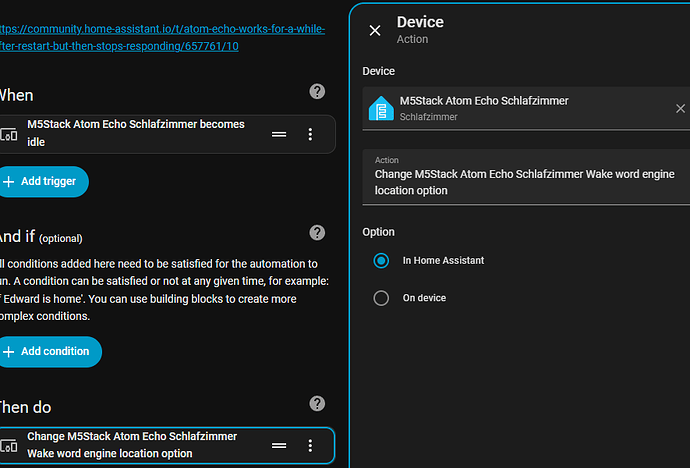

I installed and setup my m5 atom echo voice assistant in HA yesterday and with the latest versions of all software, the m5 would still cease to detect the wake word after one successful attempt. Wasted hours on this but I figured out a hacky work around.
I created an automation that detects if any of my echos become idle, then I set the “Wake word engine location” to the setting it’s on already (HA), and this has resulted in a solid experience.
This solution works perfect for me. Works all the time now :slight_smile: .

Did a bunch more testing and I’m still occasionally getting a “[E][i2s_audio.speaker:130]: Not enough memory”. So, not a 100% fix, but still a lot more stable.
I found another option that seems to have increased stability and available ram significantly.
According to the speaker perf docs for esphome (Speaker Audio Media Player - ESPHome - Smart Home Made Simple) setting enable_high_performance: false in the network component will reduce ram usage. This is seems to make the “on_tts_start: - delay: 100ms” thing that I put in previously no longer necessary. So the config looks like this now:

Did a ton more debugging and long-term testing. I found that disabling the captive portal and re-enabling the high perf network resulted in more stability.
The biggest boost to stability seemed to be disabling all references to switching between the on-device wakeword and wakeword available in HA. To be clear, this config now hardcodes the device to using the wakeword in HA, with no option to change it.
The latest config now looks like this:

Did you mean it like this for example:
Edited to add playback over other smart speakers and it seems to be working. Had to reboot the services today because neither of my atom echos were responding.
Some other tweaks that I’m gonna mess with (with my EXTREMELY limited knowledge of esphome yaml) are finding a way to shut off timers via voice command since that doesn’t seem to be working, and returning the light to the default state in your code on button press rather than shutting it off
