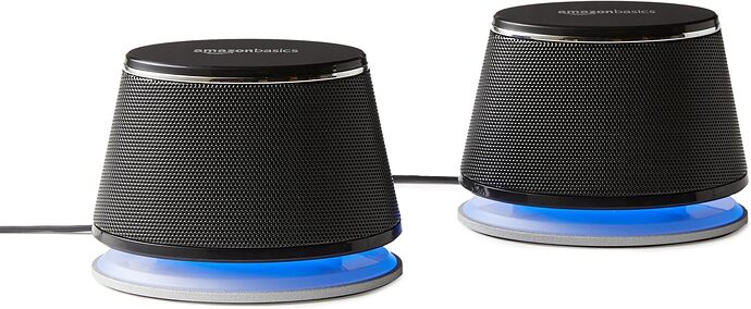

I have 1st gen atom echo. Bought usb speaker pair and separated them to install an echo in each(basically upgrading echo to 4” speaker). $15USD for 2 speakers and they sound Amazing.
I placed echo in a manner that allowed mic to function but they are mostly for announcements.
The new echo is esp-s3 I belive making it sendspin capable. I would definitely do this again presuming under $20USD for wireless speaker(voice control not needed)

Interesting option. I did some quick searching and it looks like I can buy a pair of USB speakers and two echos for around $32. Did you put the echo inside the speaker whole or just the guts?
Just the esp PWB
Desoldered echos speaker and solder usb speaker in its place (make sure you get polarity correct or sound will be weird)
The speakers I used had slot that allowed esp to fit so I cut a spot for it leaving usb power port exposed. If fit tightly so when reassembled oiliness solid fit. Only issue is led not very visible but wake word works and voice works.
Sound was good. I just wanted cheap speaker to spread around house for announcements and initial transition from Amazon. I had a bunch of echos that sounded terrible and tried this and worked great. Bathroom, laundry room, places were announcements and music is useful but voice is not necessary. Also can serve as supplemental speaker in room that already has main voice device providing surround. I didn’t expect much but easily filled 12x12 room with sound equal 3rd gen Amazon echo(I think, didn’t compare but it was good).

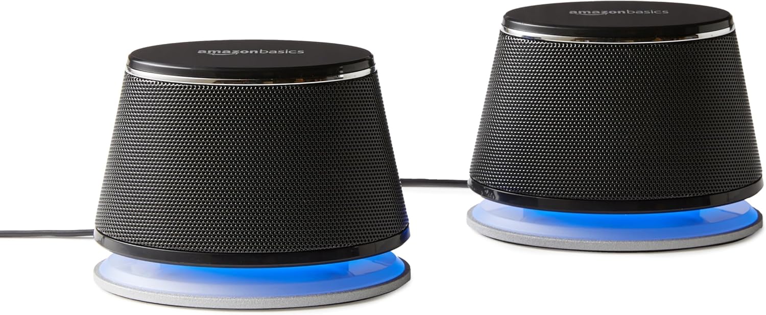

I used these
Will add picture
Mounted in back of base

Assuming the first batch goes well, the speakers you posted look good for building additional devices.
