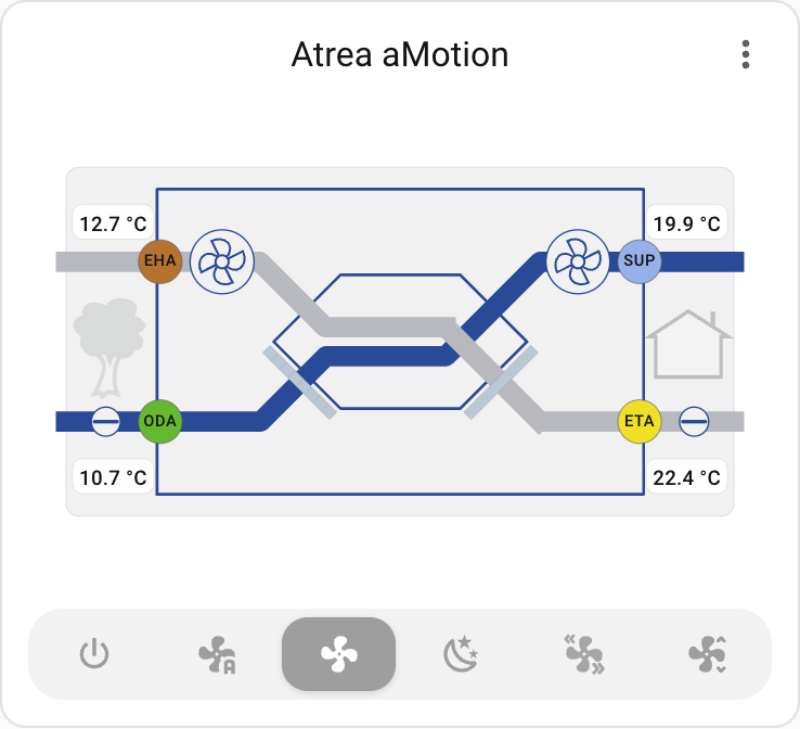

Hi all, I’ve been working on a custom Home Assistant integration for Atrea aMotion units. It talks directly to the unit over the local network using the native websocket API, so it is not a Modbus-based integration. The goal is to expose the device in a way that matches how aMotion actually works in practice, including ventilation control, climate-related controls, bypass handling, telemetry, and active-state notifications.
The integration is moving toward a capability-driven model, so entities are created based on what the specific unit actually exposes rather than forcing a fixed layout. There is also a dedicated custom Lovelace card for this integration, intended to provide a cleaner UI for the most important controls and status information.
