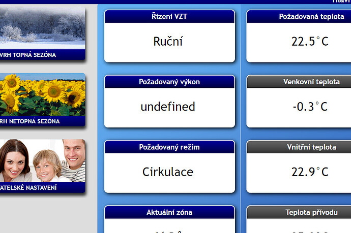

thanks for the integration. I have 1 issue with the fan speed.
I’m usint the Atrea RA5 unit, and I don’t have 15%, 20%…100% speed there but this:
for circulation:
Off, Min-Circ, Norm-Circ, max-Circ
for ventilation:
Off, Min-vent,Norm-vent, Max-vent
If I use the percentages, i get ‘undefined’ error.
any possible fix for this?
many thanks!

Hi Rudolf, I am using the following fan speeds in the Atrea coniguration: 30,31,32,33,34,35,36,37,38. The meaning of these values in the constant air flow mode is:
0 Off
10 Min - Ventilation
11 Norm - Ventilation
12 Max - Ventilation
20 Min - Circulation
21 Norm - Circulation
22 Max - Circulation
30 Min/Min - Circulation with ventilation,
31 Min/Norm - Circulation with ventilation
32 Min/Max - Circulation with ventilation
33 Norm/Min - Circulation with ventilation
34 Norm/Norm - Circulation with ventilation
35 Norm/Max - Circulation with ventilation
36 Max/Min - Circulation with ventilation
37 Max/Norm - Circulation with ventilation
38 Max/Max - Circulation with ventilation
You will not have the description of the values in the UI but at least the Atrea panel will not show undefined.
