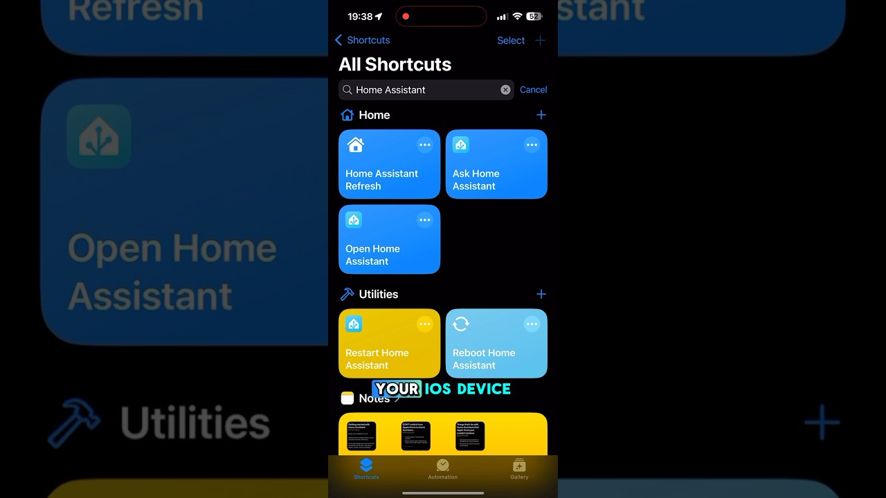

For anyone finding this thread, and frustrated by the DELAY in your phone reporting it’s status
This video explains how to set up an iPhone Sensor (On the phone) to trigger an immediate update to Home Assistant
