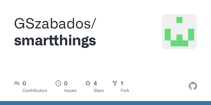

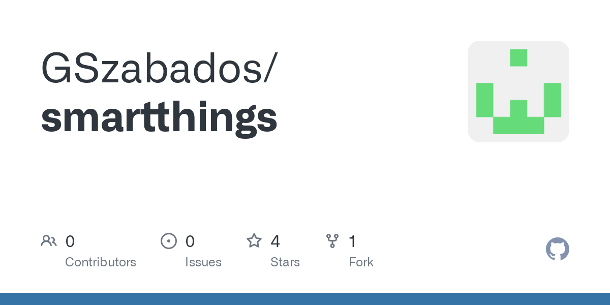

Also, there is a custom component based on the HA version of the SmartThings integration which promises all the capabilities of the SmartThings API.
You can give it a try as well…
Mother f er!!! You did it!!! That worked!!! (Sorry for the profanity…it’s the Jersey in me) It’s only showing as a switch and when I change the entity to a fan it only allows me to operate it as a switch(on/off, no speed control). I’ll play with that and see if I can get it working but either way this is good enough for my situation. THANK YOU!!!
Thank you so much for these revelations!
Previously my workaround was to make a Scene within SmartThings. These were detected and integrated into HA by the regular SmartThings integration. On, off, toggle, and setting the fan to a set speed were possible via this method. But, seeing the actual state of the fan within HA was not possible with this.
For whatever reason, even though the native Fanimation app has granular 0-100% control of fan speed, native SmartThings only has off, low, medium, high. Google Home used to have % control years ago, which then disappeared. Alexa still has full % control.
Wonderfully, the custom HAC Smartthings integration you pointed to helped! Now, the fan entity is natively visible. This new integration doesn’t seem to see % speed unfortunately, but we’ll take what we can get!

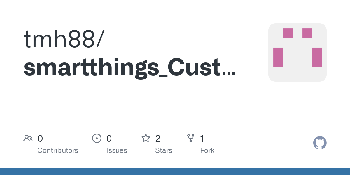

@HA-one, you can install one of the forks of that work, which is called smartthings_custom, and meanwhile use the official HA Core integration, it will not override each other, but they can be run parallel.
Otherwise, could you or @bcre3306 provide the attributes and command data from my.smartthings.com? It should show how the fan modes has been implemented.
And yes, you are right, it is very likely that you will loose some other entity content with the HACS integration. It focuses mainly on the not main attributes.

It looks like I had tried a different smartthings custom integration than the one you just listed above. It was this one, which I simply pulled from a google search:
This one did not allow the native integration to be installed at the same time.
I uninstalled that one, and installed the one you listed - tmh88.
This tmh88 custom integration does miss the aforementioned utec lock battery + Thermador appliance data, but the fan does get imported! And I just confirmed the native integration can now be installed alongside!
Here’s the export data you requested for the fan.

I fiddle arround a bit with the custom integration, deleted the previous install and loaded again, and I can clearly see, that it does not load anything which has "component": "main",, that’s why all of those entities lost with the custom integration, it loads everything else, but not the main ones, opposite to the Core integration.
Correct, no element of the fan is visible on the core integration, including the associated light switch.
In the custom one do you have light level control for the light?
Good question.
In the custom tmh88 integration, it shows as only a switch and there is no dimmer function, in HA. If I change the type from “switch” to “light” it still remains on/off only.
The native Smartthings app does show the light dimmer function as you’d expect.
Can you try this?
This would bring the contemplator1998 and the Core integration together into one. I managed to get the “main” component sensors, binary sensors and switches back, as they are in the Core integration.
I need to figure out how to update for the fan functionality, but there is a chance that it could be working as well.
As the contemplator1998 version, it will take over the place of the Core integration.
sorry been quite on this one as I’ve been traveling and not at home to test anything. Will be back tonight to see what I am seeing with the fans. Thanks for all the help!
Thank you. I just installed it (removed core and tmh88 integrations first) and it does add the fan functions + utec lock battery.
Thermador appliances are not visible however.
Also not seeing fan speed or light dimmer functions.
But a promising start!
