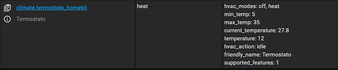

I would like to read, perhaps in a sensor card, only the current_temperature attribute of a Meros thermostat, how can I do it?
