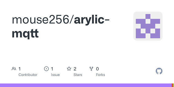

Someone has worked on a project which bridges this api to mqtt:
I’ve yet to see if this works for audiopro kit however, as it is early days and this tool requires unauthenticated mqtt. But I intend to give it a play in a few days.
I realise this is far from a solution, but documenting work all the same. At the very least proving one device is controllable via an API is a good first step to proving it could eventually be integrated into hass…
