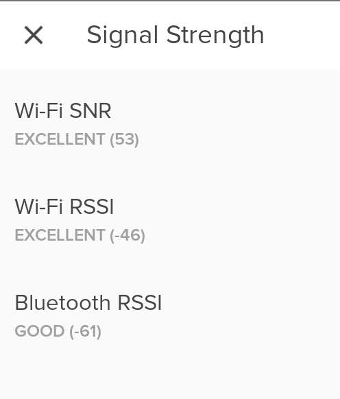

I recently installed the August Smart Lock Pro + Connect and am having the same issue.
I have a notification set to alert me via Join when the state changes from ‘unlocked’ to ‘locked’ and another when the state changes from ‘locked’ to ‘unlocked’
The lock hasn’t been touched for over 20 hours but I’ve received 3 sets of unlock and lock alerts.
Each time I received the alerts, I checked the lock and confirmed it was locked and the app shows that it was locked as well.
The signal strength of the Connect is strong
Also, when I checked the status of the Connect module, it doesn’t go offline.

When the August Connect loses connectivity to your wireless, or the lock, HA sees it as “unlocked”.
If you fix the connectivity problem, it’ll stop happening.
Keep in mind the Connect is connecting to your Wi-Fi and that seems fine, but the Connect has to also be within BT range of the lock itself. Try relocating the Connect closer to the lock, preferable with unobstructed line-of-sight.
The Connect is only a few feet away so there’s nothing I can do about the BT connectivity. The Wifi seems fine.
