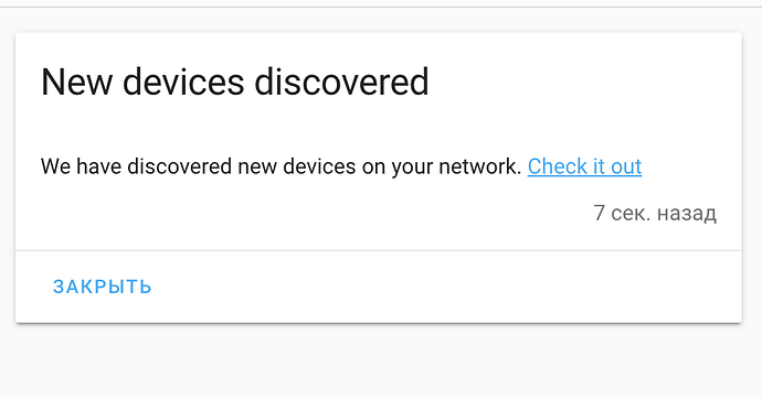

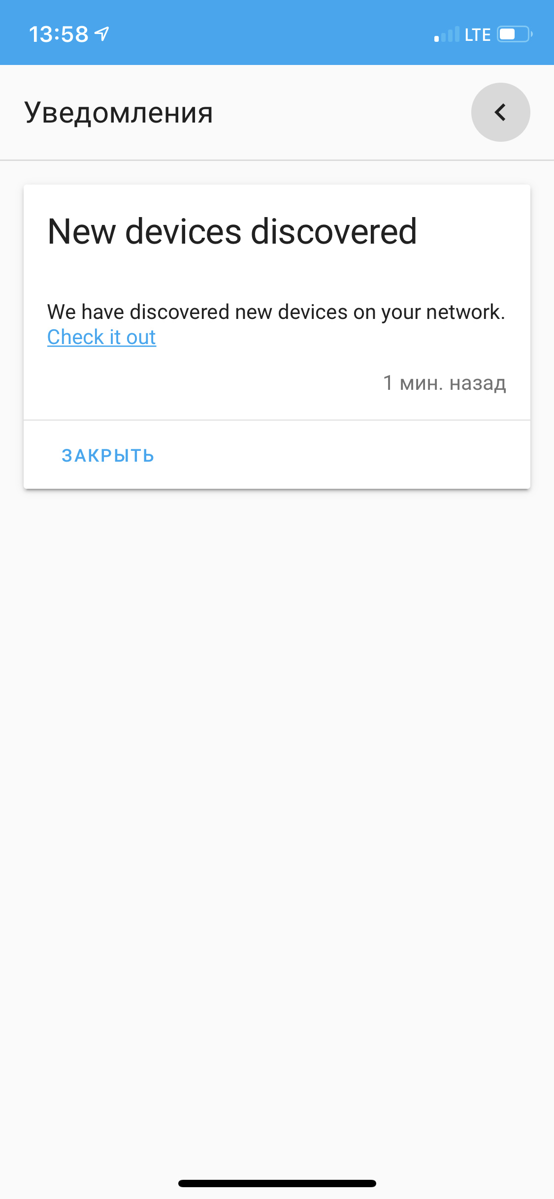

But, Home Assistant auto discovers it every … minute? Whenever I open the app/link I see notification, that new component was discovered.

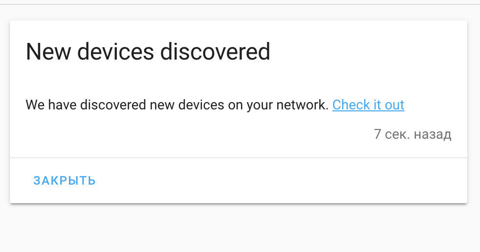

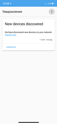

And it is always “minute ago”, “2 minutes ago”, “4 minutes ago”, even “4 seconds ago”. I always delete the notification and every time new one pops up.

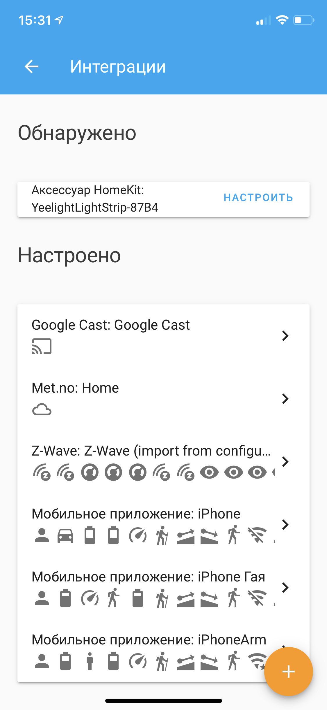

Strange thing is that if I go by the link from notification, I will see yeelight component (witch also is poping up wrongly, because I have configured it and I do not use homekit)
And here are some examples of notification. The last one is in seconds.

I have already tried to “ignore” google cast and yeelight from configuration.yaml

I already have this:
discovery:
  ignore:
    - yeelight
    - homekit
    - google_cast
