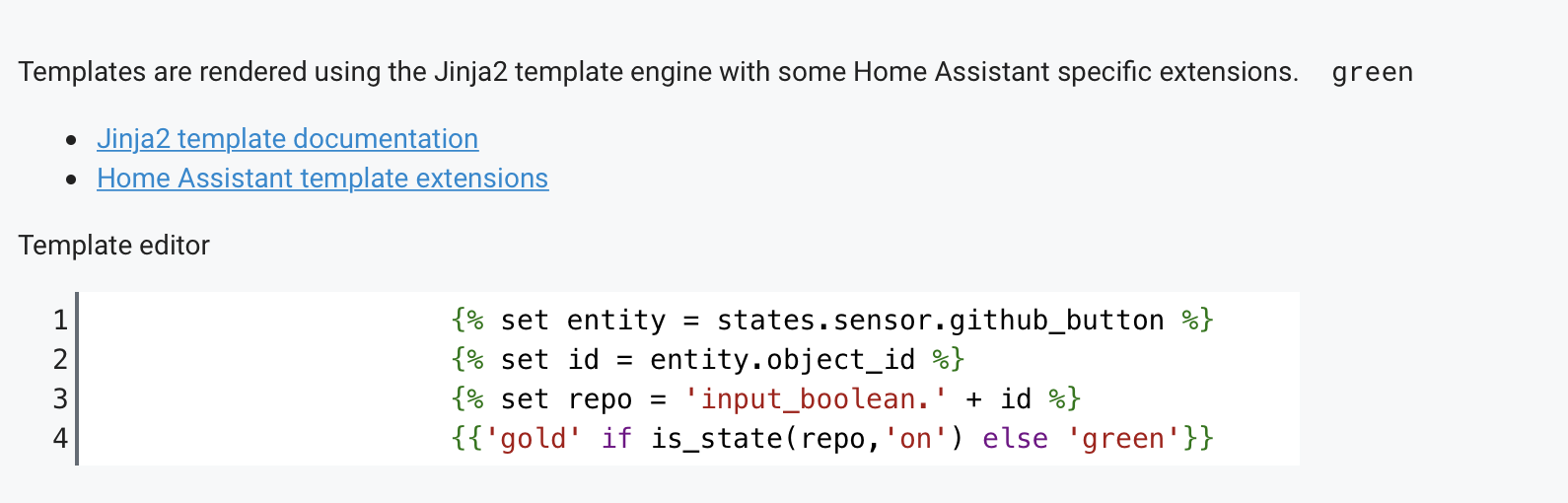

the template itself should work:
would appreciate your input…
thanks!

Try entity_id instead of object_id.

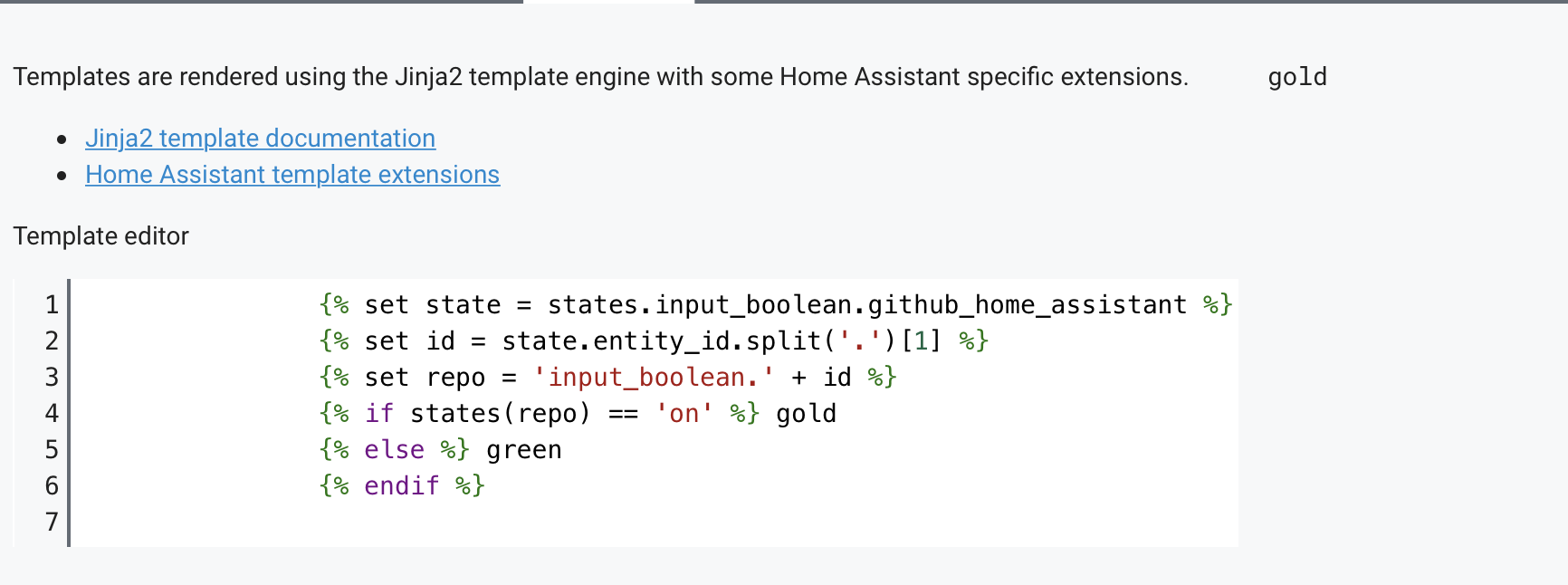

hi, thanks for chiming in!
I did try this before:
            :host {
              --paper-item-icon-color:
                {% set id = config.entity.entity_id.split('.')[1] %}
                {% set repo = 'input_boolean.' + id %}
                {% if states(repo) == 'on' %} gold
                {% else %} green
                {% endif %}
on the template-entity-row. it does nothing unfortunately. should I syntax it differently?
Actually, config.entity is the entity id, not the state object.
{% set repo = config.entity %}

i am confused, sorry…
the entity is sensor.github_home_assistant. I want those to be colored based on the input_boolean with the same object_id, input_boolean.github_home_assistant
if config.entity is the entity_id, should I then use:
            :host {
                {% set id = config.entity.split('.')[1] %}
                {% else %} green
                {% endif %}
let me try…
YESS!
thank you very much Thomas!
being the magic rule, have to memorize that…

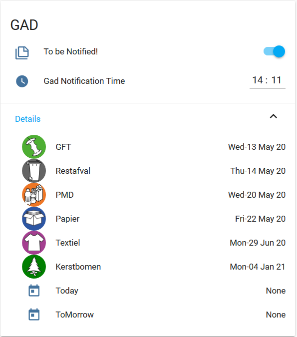

I managed to get the following combination from custom:auto-entities with custom:fold-entity-row done for which the following code applies.
title: GAD
show_header_toggle: false
entities:
  - input_boolean.notify_utility
  - input_datetime.gad_notification_time
  - type: 'custom:auto-entities'
    filter:
      include:
        - entity_id: sensor.gad_vandaag
        - entity_id: sensor.gad_morgen
        - entity_id: sensor.gad_restafval
        - entity_id: sensor.gad_gft
        - entity_id: sensor.gad_papier
        type: 'custom:fold-entity-row'
        head:
        type: section
        label: Details
          - entity_id: sensor.gad_pmd
          - entity_id: sensor.gad_textiel
          - entity_id: sensor.gad_kerstbomen
    sort:
      attribute: Sort-date
      method: attribute
      numeric: true
      entities: null
    card:
      head:
        type: section
        label: Details
However, the reverse should be applicable, i.e. the current details should stay always and the top two entities should be allowed to roll-up. I do not seem to be able to get the ā€˜custom: fold-entity-row’ visible this time. Any suggestions where I’m wrong in the revised code below?

Thanks for thinking along with me but unfortunately no luck. I started from scratch again and deleted the code associated with the custom: auto-entities.

  ha-card {
    border: solid 2px var(--primary-color);
title: GAD
type: entities
Now i need to find out how to insert the necessary lines to apply the custom:auto-entities to the top five entities such that they will be sorted based on
sort:
method: attribute
numeric: true
Any lead would be appreciated.
You could try something like:
type: custom:auto-entities
filter:
  include:
    - entity: sensor.gad_*
      sort:
        method: attribute
    - type: custom:fold-entity-row
      head:
      entities:
        - input_boolean...
        - input_datetime...
I.e. sort the waste types separately.
A filter that has a type: property will not be processed as a filter, but just passed through as it is.
Bingo!
show_empty: false
card:
  type: entities
  title: GAD
filter:
  include:
    - entity_id: sensor.gad_*
      sort:
        method: attribute
        numeric: true
    - type: 'custom:fold-entity-row'
      head:
        label: Notification Settings
        type: section
      padding: 0
      entities:
       - entity: input_boolean.notify_utility
       - entity: input_datetime.gad_notification_time
style: |
  ha-card {
title: GAD
Thanks a lot!
Thomas, this is working fine now. only issue left might be that the template isn’t auto-updating, and needs a manual refresh. Can I set an entity for the template so it updates on that entity_id?
            :host {
                {% else %} green
                {% endif %}
