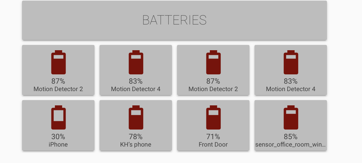

hi everyone,
can you guys look at my code to help identify why i have duplicate entities?
cards:
  - cards:
      - color: var(--disabled-text-color)
        color_type: label-card
        template: button-card-headers
        type: 'custom:button-card'
      - card:
          column_width: 26%
          justify_content: left
          layout: horizontal
          min_columns: 4
          type: 'custom:layout-card'
        filter:
          include:
            - attributes:
                battery_level: < 90
              options:
                icon: |
                    var battery_level = states['this.entity_id'].attributes.battery_level;
                    var battery_round = parseInt(battery_level / 10) * 10;
                    if (battery_round >= 100) return 'mdi:battery';
                    else if (battery_round > 0) return 'mdi:battery-' + battery_round;
                    else return 'mdi:battery-alert';
                label: |
                    var bri = states['this.entity_id'].attributes.friendly_name;
                    return bri  ;
                layout: vertical
                    var bri = states['this.entity_id'].attributes.battery_level;
                    return bri  + '%';
                show_icon: true
                show_label: true
                styles:
                  card:
                    - background-color: var(--disabled-text-color)
                  icon:
                    - color: maroon
                  label:
                    - font-size: 10px
                  name:
                    - font-size: 12px
        type: 'custom:auto-entities'
    type: vertical-stack
layout: horizontal
