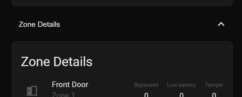

I should have been more clear… I tried those but its creating a separate Header, I’m trying to make the collapse inside the existing Auto-Entities header. Thus, looks like its a card-within-a-card, which is not what I’d like.
This is what it looks like…
this is the core code I want the entities to fold into…
type: custom:auto-entities
card:
  type: entities
  title: Zone Details

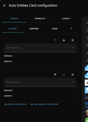

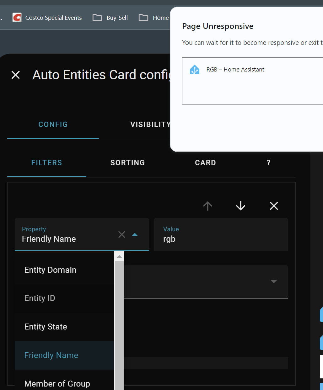

@thomasloven large system Bug… Auto-Entities card hangs / dies frequently. Especially when adding a Filter. The screen literally goes blank.
posted here…
I have over 3300 entities, so I suspect the code cant handle that. If/when I get the screen to show and Select a Property, and start entering a filter, like ā€˜RGB’ it hangs again and the screen goes completely blank. I must again click the browsers’ back button.
I have not been a coder in a long time but unless you have a different way to do the initial on-screen, I suggest disallowing the integration to instantiate any entity list if the resultant set is greater than a specific number… maybe 200 or something. On the initial add of a Filter (thus the list is unfiltered)… Keep the resultant set blank, thus requiring at least 1 Filter to be added. That should help with large systems.
Trying to add a Filter, screen blanks. If I click browser ā€˜back’, then it will show the screen…
Filter option added after above, then adding RGB text, hangs again…
When I get the screen to show, and the entities list (on the right) is empty because the Filter didnt return any values… responsiveness it as expected and I can enter/select everything just fine.

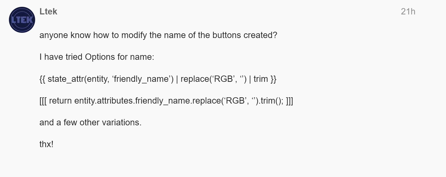

anyone know how to modify the name of the buttons created?
I have tried Options for name:
{{ state_attr(entity, ā€˜friendly_name’) | replace(ā€˜RGB’, ā€˜ā€™) | trim }}
[[[ return entity.attributes.friendly_name.replace(ā€˜RGB’, ā€˜ā€™).trim(); ]]]
and a few other variations.
thx!

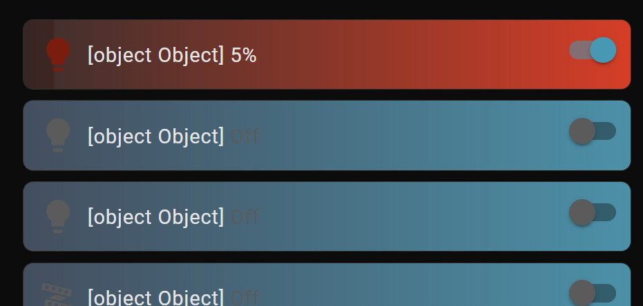

result…
What card are you using to produce the button(s)? I don’t think it’s auto-entities where you’ve posted this question.
right, I believe you’ve lost me completely.
I responded to
but now you say you need
if you keep changing your targets per post, no-one will we able to help you out… :wink:
I thought you were responding to my ask from yesterday. That post was 9 days ago :wink: … I never did figure out how to make the collapse inside the Auto-Entities header, I resorted to using a Title Card, which is not great but it works.

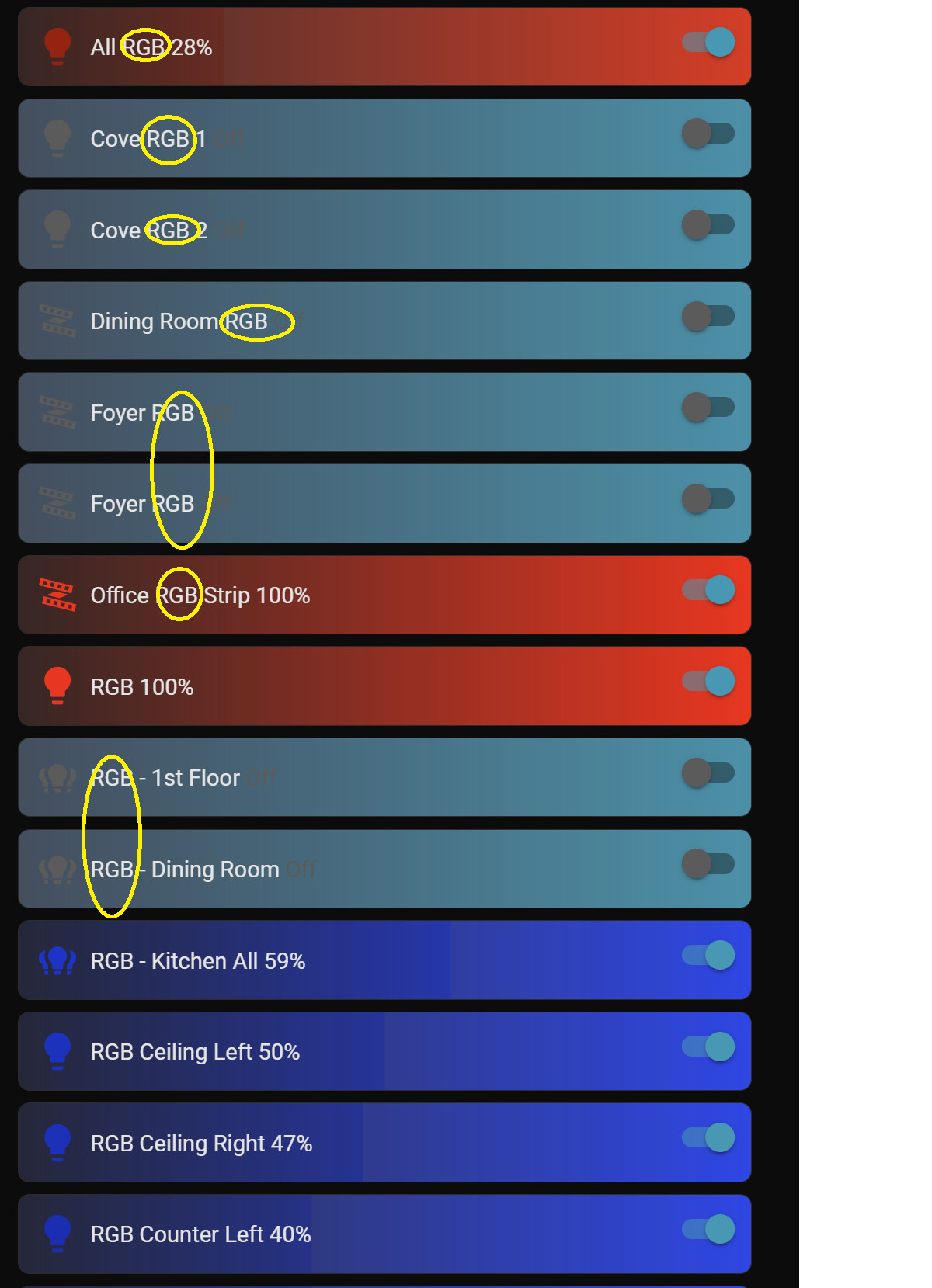

this is the code I’m trying to change the names on, to remove the RGB string…
show_empty: false
card:
  type: grid
  columns: 1
  square: false
card_param: cards
filter:
  include:
    - domain: light
      options:
        type: custom:slider-button-card
        compact: true
exclude: []
grid_options:
  columns: full
sort:
  method: friendly_name
This has nothing to with core Ha requirements . You have to follow the custom card requirements at hand. So if the embedded card uses Jinja or JS, that is what you need.
Card-mod uses Jinja . It all depends on the card and its use in the particular card config.
I don’t use that slider-card so can’t comment on that out of the box whether it supports templates at all
edit
briefly checking GitHub - mattieha/slider-button-card: A button card with integrated slider
I don’t think it does… which explains the [object Object]
you cant just make up config options that dont exist

That card doesn’t support templates or changing the entity name.

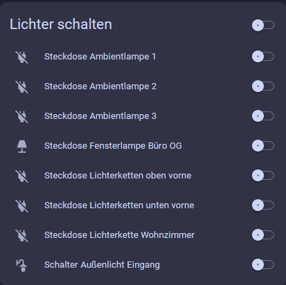

Hi!
I use labels for devices for various reasons.
One is giving devices names that are easy to understand by my family and the other is to use them for filtering devices by tokens:
Labels 1
The following auto-entities card definition shows how it works:
card:
  type: entities
  title: Lichter schalten
filter:
  template: >-
    {% set tokens = ['licht', 'lampe'] %} {% set matching_labels = labels() |
    select('search', tokens | join('|')) | list %} {% set devices =
    matching_labels | map('label_devices') | sum(start=[]) | list %} {% set
    entities = devices | map('device_entities') | sum(start=[]) | list %} {% set
    filtered_entities = entities | select('match',
    '^switch\.(?!.*_vch[0-9]+).*') | list %}
    [{% for entity in filtered_entities %} {"entity": "{{ entity }}", "name":
    "{{ label_name(labels(device_id(entity))[0]) }}"}{% if not loop.last %}, {%
    endif %}    {% endfor %}]
and how it comes out:
The only thing I’m missing ist using label-icons here to show up as string-lights, outdoor lights etc.
How can I do that. There is no function label_icon().

you can not set label icons in the auto0entities, because you can not set them at all… Auto-entities isnt some sort of wizard to change any frontend representation, it only feeds entities to the card you set it to consume…
having said that, I am not even sure I understand what you want, because label icons are not show in the dashboard at all? Only in the /config dashboards?
