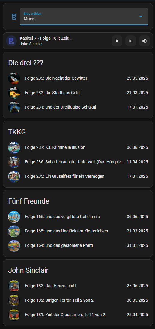

I have written a small python script ā€œHƶrspiel Catcherā€ that scrapes the last five episodes of my favorite audio play from Spotify, e.g. in this case ā€œDie drei ???ā€ and sends it via MQTT to Home Assistant.
I use ā€œauto-entitiesā€ to set up one entities card per audio play:
type: custom:auto-entities
card:
  type: entities
  title: Die drei ???
  show_header_toggle: false
filter:
  include:
    - options:
        type: custom:template-entity-row
        name: "{{ state_attr('this.entity_id', 'title') }}"
        state: >
          {% set date = state_attr('this.entity_id', 'release_date') %} {{ date
          | regex_replace('^(\\d{4})-(\\d{2})-(\\d{2})$', '\\3.\\2.\\1') }}
        entity_picture: "{{ state_attr(this.entity_id, 'entity_picture') }}"
      entity_id: /horspiel_catcher_/
sort:
  method: attribute
  attribute: release_date
  reverse: true
That is the easy and working part though. Now the pain begins. I try to use tap-action to call the play_media service and start the album on a single Sonos Speaker.
        tap_action:
          action: call-service
          service: media_player.play_media
            entity_id: media_player.unnamed_room
            media_content_type: music
            media_content_id: "{{ state_attr('this.entity_id', 'spotify_uri') }}"
            enqueue: replace
Tapping the entry results in the following error:
Die Aktion media_player/play_media konnte nicht ausgeführt werden. Error calling SonosMediaPlayerEntity._play_media on media_player.unnamed_room: UPnP Error 714 received: Illegal MIME-Type from 10.0.0.55
I have tried so many different solutions back and forth, that i do not know what else I can try.
From what I understand, the tap_action part has to be (???) in a template part in the filter? At the moment the spotify_uri seems not to be resolved and is just text sended to the Sonos speaker, when I insert a hardcoded one, the action just works and in the dev tools too:
action: media_player.play_media
  entity_id:
    - media_player.unnamed_room
  media_content_id: spotify:album:0qZ0R61AqoD2i8GnzUk91C
What am I doing wrong here / do not get?

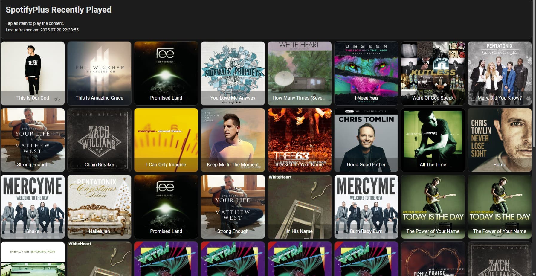

I just put this together for use with the SpotifyPlus integration. You might be able to do something similar with your requirements. Note that ALL of this is done in HA (no Python scripts nor MQTT required). It also plays on the specified Sonos device when a tile graphic is clicked.
Recently Played Dashboard
Displays the Spotify Recently Played list for a given SpotifyPlus media player.
This will allow you to select a recently played item for play on the media player by tapping on a track image.
How it Looks
How it Works
A template trigger is defined (via configuration.yaml) that will fire when the integration updates its media_content_id attribute (e.g. a Spotify track uri value). The integration updates this attribute whenever the current track ends, and a new track begins.
The template trigger action calls the integrations’ get_player_recent_tracks service to retrieve the current list of Spotify recently played entries. The list is returned as service response data, which gets stored to a variable named service_response.
The template trigger sensor step updates the sensor.spotifyplus_recent_info template sensor state to the current datetime value. It also sets the tracks attribute with a summarized list of recently played track data: name, uri, image_url, and artist.
The template sensor can then be referenced in Lovelace UI cards that support templates.

Lovelace UI Card Definition
Add the following YAML to a dashboard of your choice. I chose a View Type of Panel (1 card) for my dashboard, so it covers the entire width of the viewport.
This will dynamically build and format the recently played list into a grid with cover artwork and titles.
You will need to make the following changes to the yaml:
  • change media_player.YOUR_SPOTIFYPLUS_ENTITY_ID to your SpotifyPlus media player entity_id (e.g. media_player.spotifyplus_username)
  • change YOUR_DEVICE_ID to the Spotify Connect device id you want to play the track on (e.g. Office Speaker)
type: vertical-stack
cards:
  - type: markdown
    content: |-
      # SpotifyPlus Recently Played
      Tap an item to play the content.
      Last refreshed on: {{ states('sensor.spotifyplus_recent_info') }}
  - type: custom:auto-entities
    card:
      type: grid
      columns: 8
    card_param: cards
    filter:
      template: >-
        {% set serviceResponse = None -%}
        {%- set itmMediaPlayerEntityId = 'media_player.YOUR_SPOTIFYPLUS_ENTITY_ID' -%}
        {%- set itmDeviceId = 'YOUR_DEVICE_ID' -%}
        {%- if has_value('sensor.spotifyplus_recent_info') -%}
        {%-   set serviceResponse =
        state_attr('sensor.spotifyplus_recent_info','tracks') -%}
        {%- endif -%}
        {%- if serviceResponse != None -%}
          {%- for track in serviceResponse -%}
            {%- set trackImageUrl = track['image_url'] | default('/local/spotifyplus/default.png') -%}
            {%- set trackName = track['name'] | default('unknown') -%}
            {%- set trackUri = track['uri'] | default('') -%}
        'type': 'picture-entity', 'entity':
        'input_boolean.always_enabled_helper', 'image': trackImageUrl,
        'show_state': false, 'show_name': true, 'name': trackName,
        'tap_action': {
          'action': 'perform-action',
          'perform_action': 'spotifyplus.player_media_play_tracks',
          'data': {
            'entity_id': itmMediaPlayerEntityId,
            'uris': trackUri,
            'device_id': itmDeviceId
          {%- endfor -%}
        {%- endif -%}

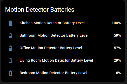

I wanted to share the progression that I made with one of my auto-entities cards. Special thanks goes out to @Mariusthvdb for pointing me in the right direction to get the card_mod to work in the final result and @Ildar_Gabdullin’s Entities card post in the card_mod thread.
This is what I started with using - entity_id: sensor.*_motion_detector_battery_level include:
Code
card:
  type: entities
  title: Motion Detector Batteries
  card_mod:
    style: |
      ha-card {
        background: black;
        --primary-text-color: white;
filter:
  include:
  exclude:
    - options: {}
      state: unavailable
    - options: {}
      hidden_by: user
sort:
  method: state
  numeric: true
  reverse: true

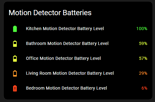

I added card_mod to colorize the states and icons using the red-to-green scale template that I posted in Green-to-red icon color gradient template (battery percentage).
Code
card:
  type: entities
  card_mod:
    style: |
      ha-card {
        background: black;
filter:
  include:
      options:
        card_mod:
          style:
            hui-generic-entity-row $: |
              {% set percentage = states(config.entity) | int %}
              {% set r, g, b = 0, 0, 0 %}
              {% if (percentage <= 51) %}
                {% set r = 255 %}
                {% set g = (5.0 * percentage) | round | int %}
              {% else %}
                {% set g = 255 %}
                {% set r = (505 - 4.89 * percentage) | round | int %}
              {% endif %}
              {% set gradient = "#%0x" | format( r * 0x10000 + g * 0x100 + b * 0x1 ) %}
              .state { color: {{ gradient }} }
              state-badge { color: {{gradient}}; }
  exclude:
    - options: {}
      state: unavailable
    - options: {}
      hidden_by: user
sort:
  method: state
  numeric: true
  reverse: true
I did not like how each entity had Motion Detector Battery Level in the name. To fix this, I knew I needed to be able to use a template to get the entities, replace the text, and still apply the card_mod. This is the end result.
Code
card:
  type: entities
  card_mod:
    style: |
      ha-card {
        background: black;
unique: entity
show_empty: true
filter:
  template: |
    {%- set device_list = states.sensor
      | selectattr('entity_id', 'search', 'motion_detector_battery_level')
      | rejectattr('state' , 'in' , ['unknown','unavailable'])
      | map(attribute='entity_id')
      | list -%}
    {%- for device in device_list -%}
        'entity': device,
        'name': state_attr(device, "friendly_name") | regex_replace(find='Motion Detector Battery Level', replace='', ignorecase=true) ,
        'card_mod':
          {'style':
            {'hui-generic-entity-row $': '
                {% set r = 255 %}
              {% else %}
                {% set g = 255 %}
              {% endif %}
              .state { color: {{ gradient }}; }
              state-badge { color: {{ gradient }}; }'
    {%- endfor -%}
sort:
  method: state
  reverse: true
  numeric: true

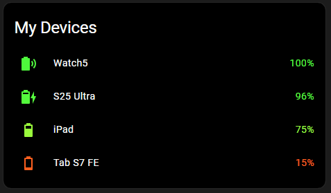

The final template can be easily adapted to use a list of entities similar to the standard include: method where a complex template is not needed but can still utilize the rest of the code.
Code
{%- set device_list = [
  'sensor.s25_ultra_battery_level', 'sensor.watch5_battery_level',
  'sensor.tab_s7_fe_battery_level', 'sensor.ipad_battery_level'

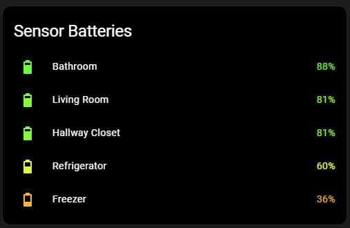

UPDATE: This example shows how to find multiple strings to be removed from the displayed name. regex_replace(find='Battery Level|Door|Battery', replace='', ignorecase=true)
Code
card:
  type: entities
  title: Sensor Batteries
  card_mod:
    style: |
      ha-card {
        background: black;
unique: entity
show_empty: true
filter:
  template: |
      'sensor.refrigerator_battery','sensor.freezer_battery',
      'sensor.living_room_door_battery_level','sensor.bathroom_door_battery_level',
      'sensor.hallway_closet_battery_level'
        'entity': device,
        'name': state_attr(device, "friendly_name") | regex_replace(find='Battery Level|Door|Battery', replace='', ignorecase=true),
        'card_mod':
          {'style':
                {% set r = 255 %}
              {% else %}
                {% set g = 255 %}
              {% endif %}
    {%- endfor -%}
sort:
  method: state
  reverse: true
  numeric: true

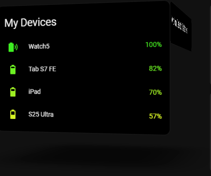

At the risk of going off-topic, here’s how I’ve brought this all together. I use the /breakthestatic/swipe-card (which is a little more up-to-date than /bramkragten/swipe-card).
20250809-2231
Code
type: custom:swipe-card
start_card: 2
parameters:
  effect: cube
  loop: true
  freeMode: true
  speed: 4000
  autoplay:
    delay: 2500
    disableOnInteraction: false
    reverseDirection: false
    stopOnLastSLide: false
cards:
    card:
      type: entities
      title: My Devices
      card_mod:
        style: |
          ha-card {
            background: black;
    unique: entity
    show_empty: true
    filter:
      template: |
          'sensor.tab_s7_fe_battery_level', 'sensor.dereks_ipad_battery_level'
            'entity': device,
            'name': state_attr(device, "friendly_name") | regex_replace(find='Battery Level', replace='', ignorecase=true) ,
            'card_mod':
              {'style':
                    {% set r = 255 %}
                  {% else %}
                    {% set g = 255 %}
                  {% endif %}
        {%- endfor -%}
    sort:
      method: state
      reverse: true
      numeric: true
    card:
      type: entities
      card_mod:
        style: |
          ha-card {
            background: black;
    unique: entity
    show_empty: true
    filter:
      template: |
          | list -%}
            'entity': device,
            'name': state_attr(device, "friendly_name") | regex_replace(find='Motion Detector Battery Level', replace='', ignorecase=true),
            'card_mod':
              {'style':
                    {% set r = 255 %}
                  {% else %}
                    {% set g = 255 %}
                  {% endif %}
        {%- endfor -%}
    sort:
      method: state
      reverse: true
      numeric: true
    card:
      type: entities
      card_mod:
        style: |
          ha-card {
            background: black;
    unique: entity
    show_empty: true
    filter:
      template: |
            'entity': device,
            'card_mod':
              {'style':
                    {% set r = 255 %}
                  {% else %}
                    {% set g = 255 %}
                  {% endif %}
        {%- endfor -%}
    sort:
      method: state
      reverse: true
      numeric: true

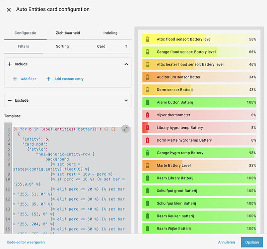

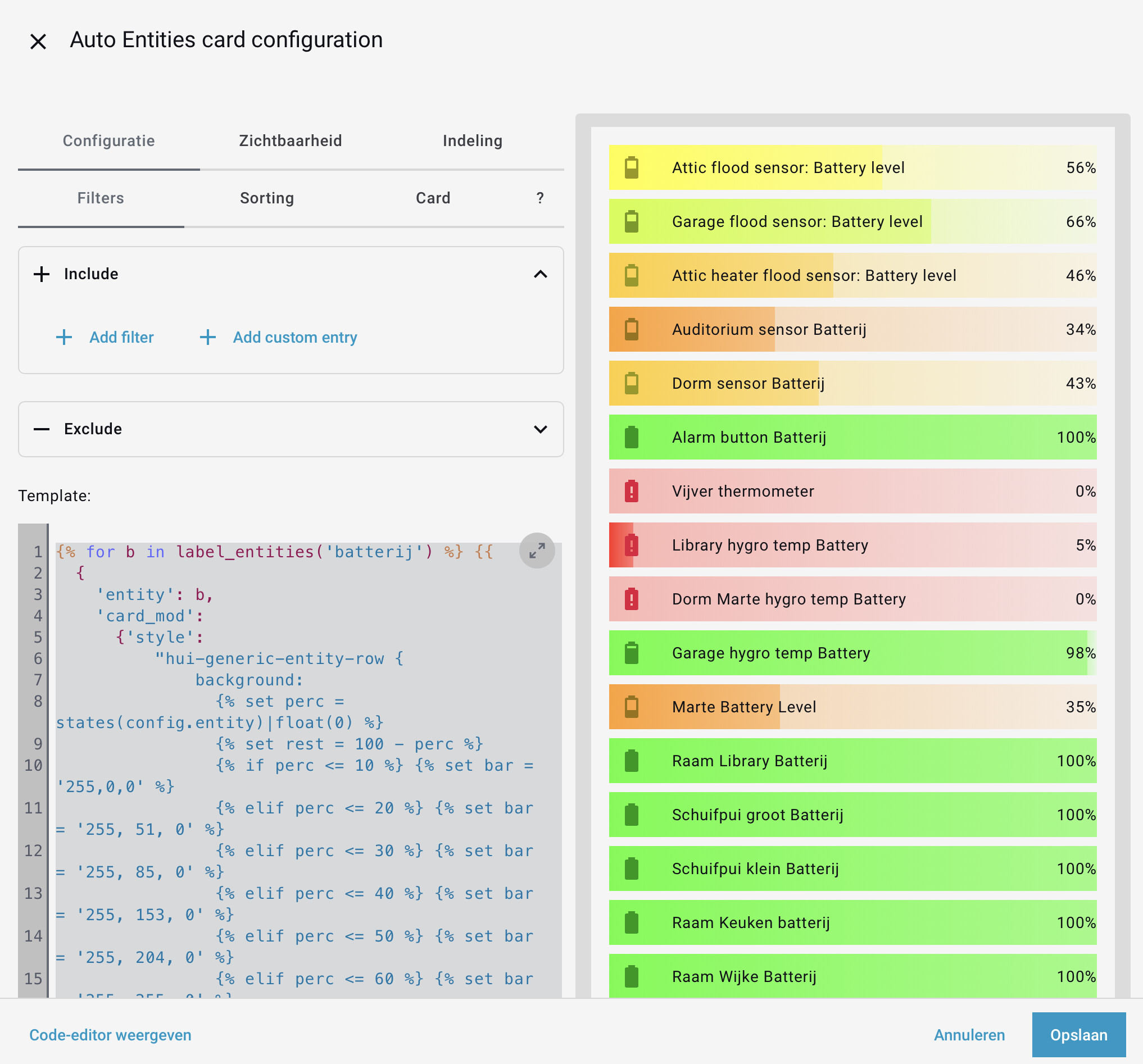

yes, nice! we have too few examples of filter templates with more complex card-mod stylings, so this is great resource material. Let me add one that we handled in the process:
{% for b in label_entities('batterij') %} {{
    'entity': b,
    'card_mod':
      {'style':
          "hui-generic-entity-row {
              background:
                {% set perc = states(config.entity)|float(0) %}
                {% set rest = 100 - perc %}
                {% if perc <= 10 %} {% set bar = '255,0,0' %}
                {% elif perc <= 20 %} {% set bar = '255, 51, 0' %}
                {% elif perc <= 30 %} {% set bar = '255, 85, 0' %}
                {% elif perc <= 40 %} {% set bar = '255, 153, 0' %}
                {% elif perc <= 50 %} {% set bar = '255, 204, 0' %}
                {% elif perc <= 60 %} {% set bar = '255, 255, 0' %}
                {% elif perc <= 70 %} {% set bar = '204, 255, 0' %}
                {% elif perc <= 80 %} {% set bar = '153, 255, 0' %}
                {% elif perc <= 90 %} {% set bar = '102, 255, 0' %}
                {% else %} {% set bar = '51, 255, 0' %}
                {% endif %}
                linear-gradient(to right, rgb({{bar}},0.9) 0%, rgb({{bar}},0.6) {{perc}}%,
                                          rgba({{bar}},0.3){{perc}}%, rgba({{bar}},0.1) 100%);
            :host {
              --card-mod-icon-color:
                {% if perc <= 10 %} rgb(225, 20, 60)
                {% elif perc <= 20 %} rgb(153, 38, 0)
                {% elif perc <= 30 %} rgb(153, 38, 0)
                {% elif perc <= 40 %} rgb(153, 115, 0)
                {% elif perc <= 50 %} rgb(153, 153, 0)
                {% elif perc <= 60 %} rgb(153, 153, 0)
                {% elif perc <= 70 %} rgb(115, 153, 0)
                {% elif perc <= 80 %} rgb(77, 153, 0)
                {% elif perc <= 90 %} rgb(38, 153, 0)
                {% else %} rgb(0, 153, 0)
                {% endif %};
}},{% endfor %}
it is an exercise in quoting, but in this case turned out to be way simpler than I had figured. I just dropped in the complex bit after 'style': inside double quotes to make that a single string and the mod was there.
it is essentially the filter template variant of this include version
Yaml for the 'include' version
card:
  type: entities
  title: Battery Status
  card_mod:
    class: class-header-margin
    style:
      hui-sensor-entity-row:
            height: 25px;
            padding: 0px 16px;
            border-radius: var(--ha-card-border-radius);
            border: 1px groove var(--divider-color);
        ha-card {
          color: var(--secondary-color);
          font-weight: 400;
        .card-content {
          max-height: 450px;
          overflow-y: scroll;
  state_color: false
filter:
  include:
    - options:
        card_mod:
          style: |
              background:
                {% endif %}
            :host {
                {% endif %};
      entity_id: sensor.*_battery_level
sort:
  method: state
  numeric: true
  reverse: false
show_empty: false
I am trying to make a low battery warning card that will leverage the entities created by Battery Notes. I have been able to successfully create cards that
  1. Populate device battery levels that are below a defined threshold, i.e. lower than 20%, and…
  2. Populate with devices with low batteries using the battery_low entity (binary_sensor.*_battery_sensor_low)
What I am trying to create is a card that will use both. The card would display that battery level when the battery falls below the Battery Notes low battery threshold. So when a sensor ā€œbinary_sensor.*_battery_sensor_lowā€ is ā€œonā€, then the card will display the device and the battery level. I have been trying to creat the card without having to make an entry in the code for each sensor, but rather one that would work off of any device in the battery notes integration.
So far, everything I have tried has not worked.
Anyone have any tips?
Have you looked at the Low battery level detection & notification for all battery sensors blueprint?
Low battery level detection & notification for all battery sensors - Blueprints Exchange - Home Assistant Community
@anon60850888 I have, and if I understand that blueprint correctly, it works similarly as an auto-entities card that will populate when a battery falls below a predetermined level. That predetermined level then is the same for all batteries. What I am trying to accomplish is varying levels for different batteries, and this is where integrating the ā€˜binary_sensor.*_battery_sensor_low’ comes in. Inside of the Battery Notes integration, you can set different low levels for each battery. When that individual battery falls below it’s predetermined level set in the sensor provided by the Battery Notes integration, it would be considered low. This way I could have one battery below at 30% and another at 20%, all individually configurable from battery notes and not having to change the code in the Auto-Entity for each battery.
