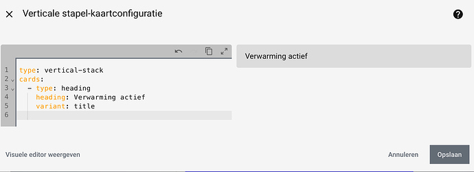

What do you mean with ā€œdoes nothingā€? By duplicating the auto-entities filter, both the heading-title as the underlying tiles appear/disappear when needs.
If I take the heading outside auto-entities, I could indeed work with visibility-conditions. But the condition would need to be ā€œwhen auto-entities do not have any tile to show, don’t show the headerā€. And I don’t know how to do that (besides duplicating my auto-entities filter).
Thanks for your help. I am getting there. :slight_smile:

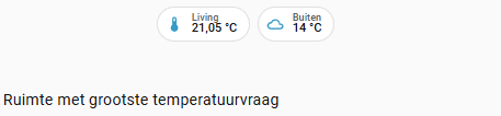

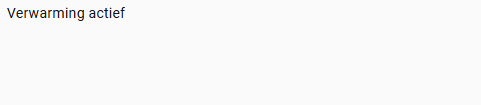

as you can see in my first screenshot, there are no populated cards with that code, except for the heading
I have quite a few climate entities, and in a correct config they would have showed up
the condition would have to be when any climate entity is active… Or so I understood your configuration
1 simple helper (binary_sensor) would suffice

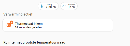

Strange. That behaviour is different here. If there is one entity visible (cfr screenshot), I see both the header and the tile.
When no entities are shown, the header also dissappears.
You’re right. I can also try it this way.

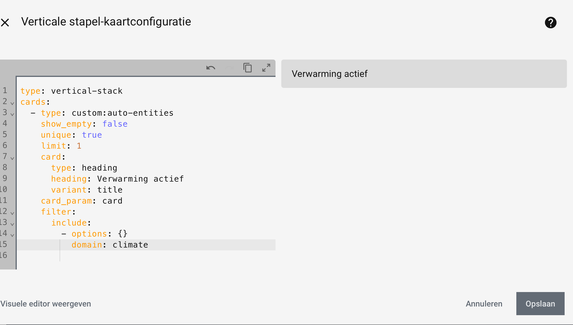

can you create a new card with only this:
type: custom:auto-entities
show_empty: true
card:
  type: heading
  heading: Verwarming actief
  # variant: title #dont use this as it is not correct option, should be `heading_style`
card_param: card
filter:
  include:
    - options: {}
      domain: climate
and post the result in the view?

Scenario 1: one climate entity is active. The climate entity is shown, and also the header:
Scenario 2: no climate entities are active. Also the header is hidden (which is good):
Scenario 3: multiple climate entities are active:
So all three scenario’s behave as how I want it. So the header is shown/not shown when needed.
This is good, right?
if that is what you are after sure, looking good

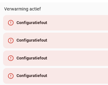

Some things I noticed:
  • hvac_action: ā€œonā€ should be hvac_action: ā€œheatingā€ apparantly (I forgot this myself). And you have many types of hvac actions (cooling,…). So that why probably I initially chose to exclude some states;
  • After forementioned adjustment, I get this:
