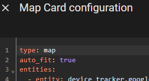

If you go into the card configuration and edit the yaml code, you will be able to add
auto_fit: true
This will automatically scale the map and keep all tracked entities visible
