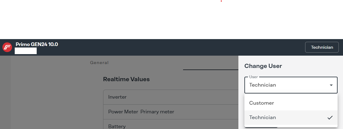

Might it be that the gen24 per default talks on https?
You might need to check also that the service account is enabled.
I made a change to the proxy that is can be configured to use https.
Can you try if this solves it for you?
By service account do you mean technician account or is there actually an account called service?
The technical account
The technical account and try with https
