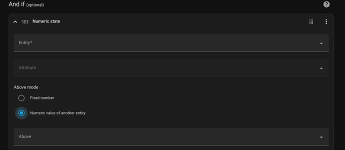

in the ui it’s here:
see how it says abve “numeric value of another entity”
put the entity (the helper you made) in that box just below it.
