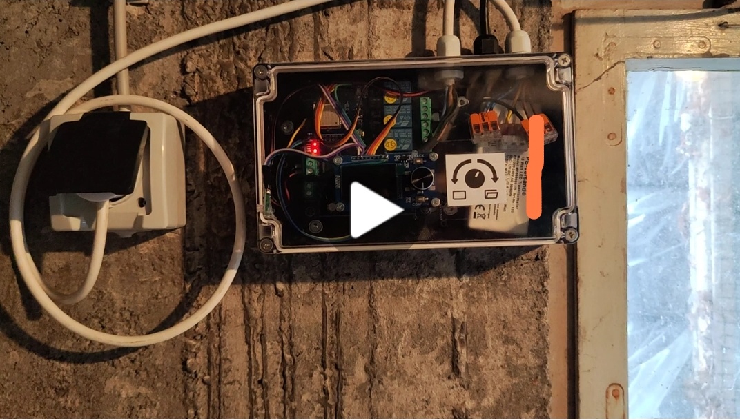

:play_button: Example Video
Video

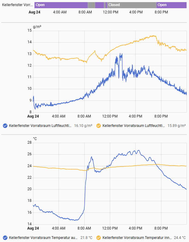

:rocket: Results
I let it run for over a week now and it’s doing it’s job quite well:
Video
:yellow_circle: = inside values / :blue_circle: = outside values
