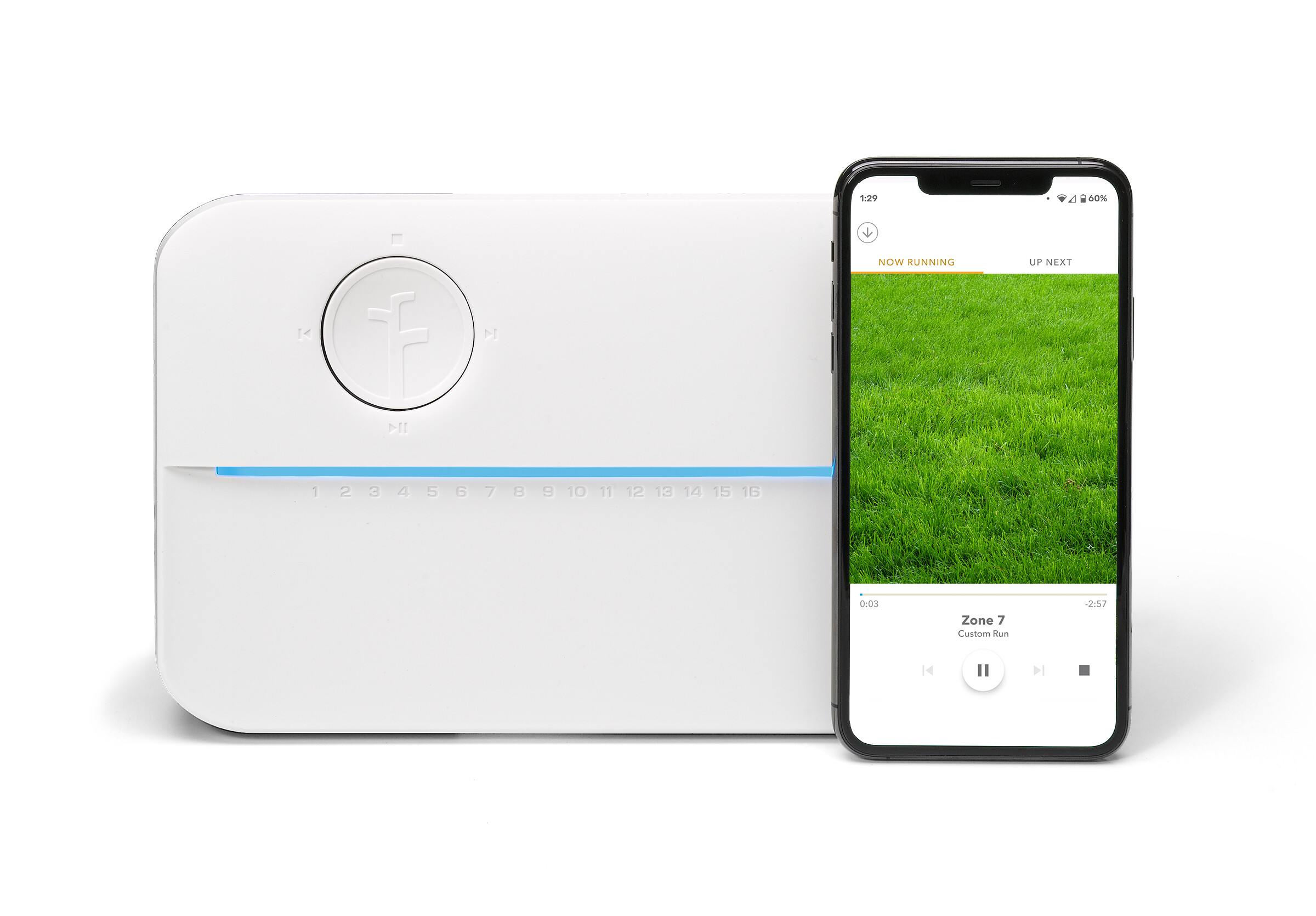

Controllers however… I will plug the ever loving crap out of Rachio controllers, they are the bomb. The app is amazing and straight forward compared to any other I’ve tried. They will automatically check local forecasts and adjust watering according to rain/wind/freezing/ground saturation/whatever. You also have the option to hook up your own weather station for this info, they naturally connect with Tempest (native HA integration available) weather stations. They also have an open API and a native HA integration maintaned by a core dev. I did not know that last part when I fell in love with these for my clients, it was just icing on the cake.

@HappyCadaver Do Rachio controllers have direct integration with HA without brand routers? Actually the same question for Rainbirds.

Any benefits using for example Rachio controller vs HA + 24V controller? I assume you install Rachio on the first place, because you can’t say your clients to use HA :slight_smile: Is it correct?

LOL pretty much, I also hadn’t started using HA when I discovered Rachio. That said Rachio does already have the code logic in place for weather/season adjustments which means less work on the user end to automate all that.
Rachio’s open api with the native integration does allow for overiding their app/code with HA automations, but I wouldn’t do that for my clients. I might be tempted to do it for myself if I had an irrigation system though :laughing:.

Agreed, Rainbirds wireless is junk. Solid enough controllers but require physical interaction. Rachio on the other hand is the bomb wirelessly.
@kwladyka a Blueprint was just released that might be of some interest to you to save time with writing automations and whatnot. I Haven’t looked at the yaml itself yet, but it seems to cover some good ground.
Is it this one which you recommend? It has HA integration, right? It will work with RainBird valves.
Any alternative? It is hard to find this controller in my country. Maybe I will find it to import from somewhere if decide to use instead of simple 12 / 24 V controller.
