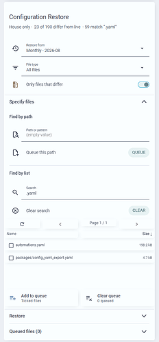

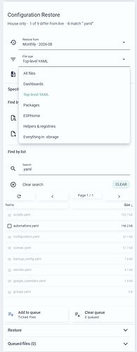

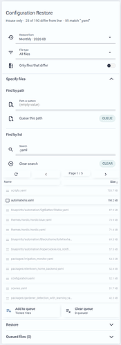

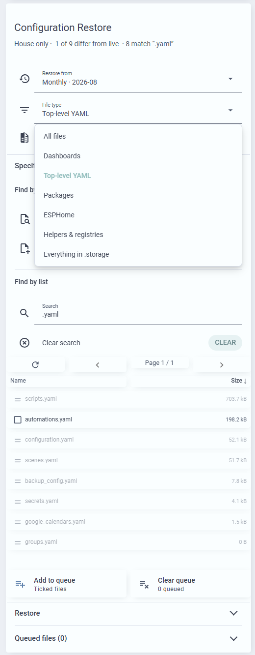

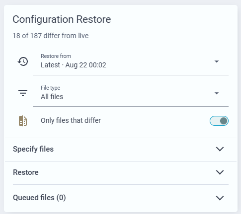

It has gained selective file-by-file restore, search and sorting, optional redaction and encryption, and several minor fixes. The code in the next two posts below is the original version and is kept for reference; install from the repository instead. Later posts in this thread announce what has changed since.

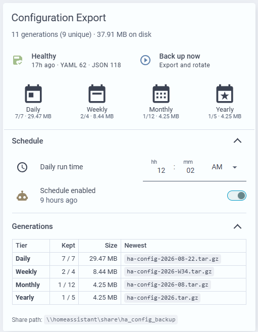

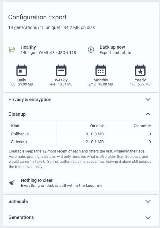

So I put together a script that quickly and compactly exports every user-configurable YAML and JSON file to a Samba share, browsable on your PC/Mac/Linux desktop, on a schedule, converts the UI-managed JSON in .storage into readable YAML, and keeps generational copies — 7 daily, 4 weekly, 12 monthly, 5 yearly. Plus a dashboard card to run it, schedule it, and see what’s on disk.
What it does
  • Copies every *.yaml, *.yml and *.json in your config directory
  • Copies all of .storage — helpers, entity/device/area/floor/label registries, energy config, exposed entities, config entries
  • Converts every JSON file to YAML alongside the original, so you can read and diff them
  • Extracts each UI dashboard from its .storage wrapper into a ready-to-use YAML-mode dashboard file
  • Fetches the Frigate add-on config over its API (add-on configs aren’t readable from the HA Core container)
  • Keeps GFS generations with hardlinks, so 28 generations cost roughly the size of one
  • Maintains an uncompressed latest/ mirror for browsing and diffing without extracting anything

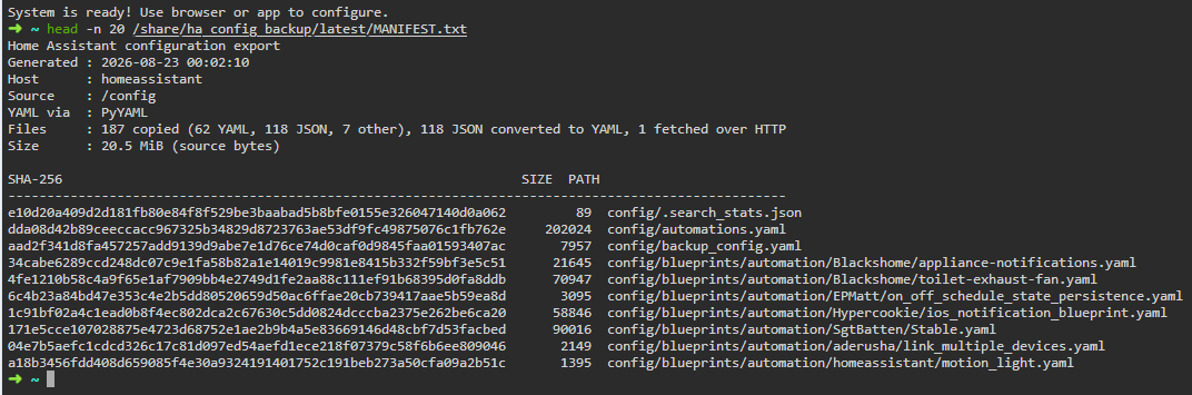

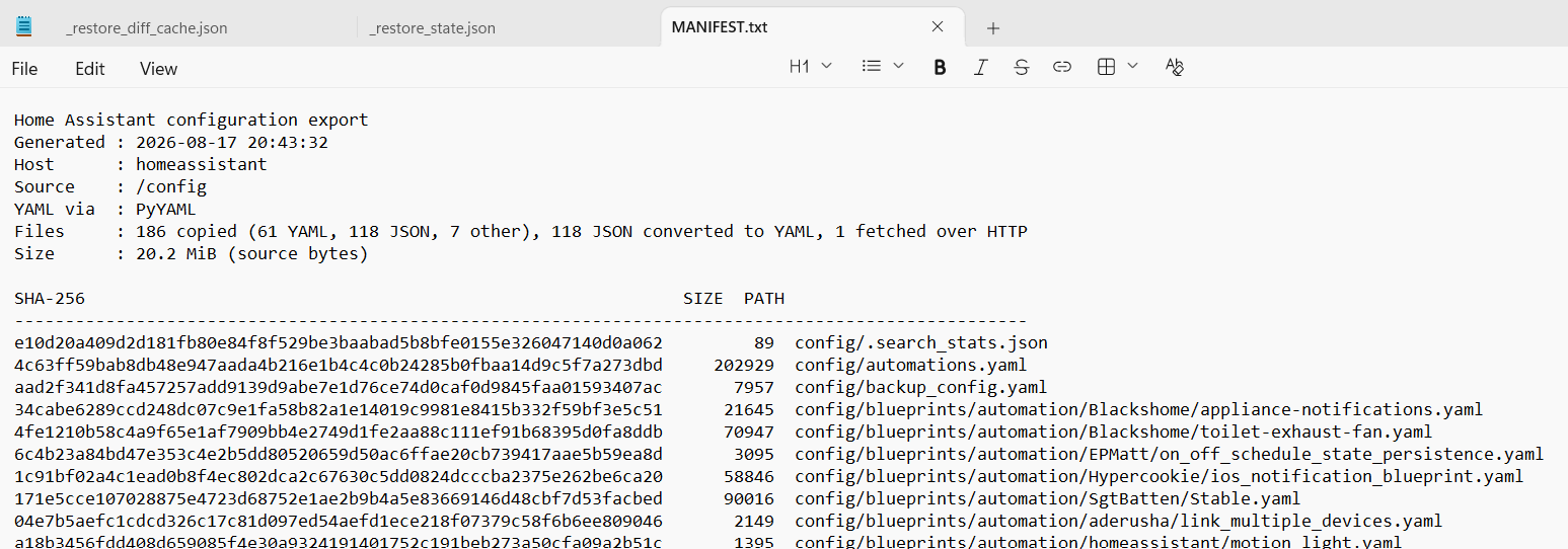

  • Writes a MANIFEST.txt with SHA-256 per file, so diffing two generations tells you exactly what changed
Typical run here: ~190 files, ~120 converted to YAML, 4.3 MB compressed, 12 seconds.

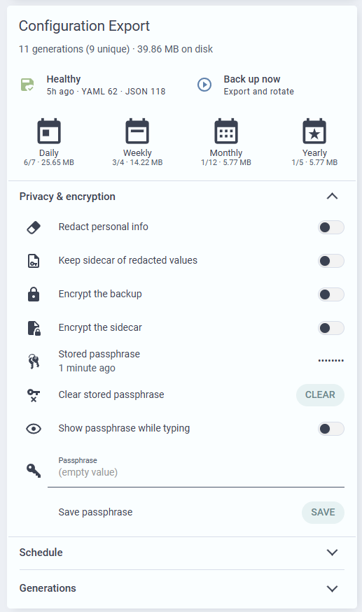

:warning: Nothing is redacted. secrets.yaml, .storage/auth*, API tokens, ADB keys, camera RTSP credentials and Frigate’s raw config all land in the share in plaintext. That is intentional — it’s what makes this restore-grade — but the destination deserves the same protection as your config directory. Don’t put it anywhere world-readable.

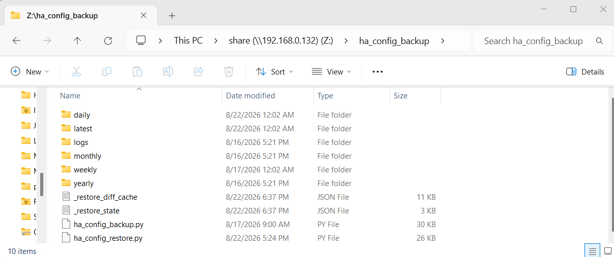

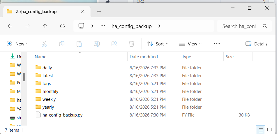

Step 2 — Install the script

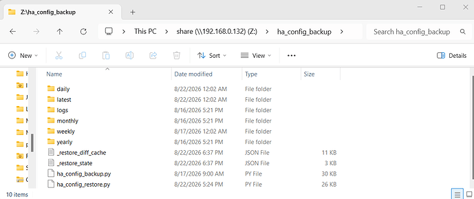

Create a folder ha_config_backup in the share and drop ha_config_backup.py into it, so it lands at /share/ha_config_backup/ha_config_backup.py.
It lives in the share rather than in /config for two reasons: Home Assistant updates can never touch it, and the backups sit next to it where you can already reach them from your desktop. The script locates its own directory, so moving the whole folder elsewhere just works.

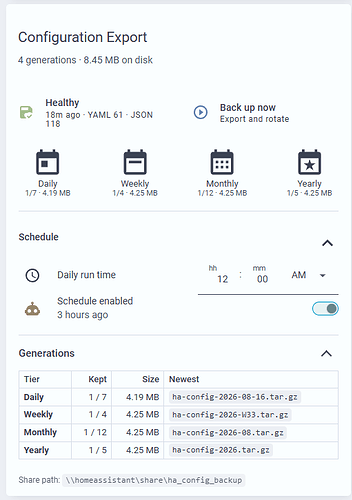

Save as /config/packages/config_yaml_export.yaml and reload. This creates:
Entity Purpose
input_datetime.config_export_time Run time, settable from the card
script.config_export_run_now The “Back up now” button
automation.config_export_daily The schedule
sensor.config_export_status Status plus per-tier generation inventory
Change the notify service in the failure branch to your own, or delete it — failures also raise a persistent notification, which always works.

Then press Back up now and check /share/ha_config_backup/latest/. Logs land in logs/backup.log; logs/last_run.json feeds the sensor.

Output layout (BACKUP_ROOT):
    ha_config_backup.py
    latest/                       uncompressed mirror of the newest run
    daily/   ha-config-2026-08-16.tar.gz
    weekly/  ha-config-2026-W33.tar.gz
    monthly/ ha-config-2026-08.tar.gz
    yearly/  ha-config-2026.tar.gz
    logs/    backup.log, last_run.json
Snapshot layout (inside each archive / inside latest/):
    config/      verbatim copies of *.yaml, *.yml, *.json from the HA config dir
    storage/     verbatim copies of .storage/* (JSON, no extension)
    addon_configs/  add-on configs, when reachable (SSH add-on only)
    yaml/        YAML conversions of every JSON file above, same tree shape
    lovelace/    ready-to-use dashboard YAML, unwrapped from .storage/lovelace*
    MANIFEST.txt file inventory with sizes and SHA-256

def write_manifest(snap: Path, config_dir: Path, stats: Stats) -> None:
    lines = [
        "Home Assistant configuration export",
        f"Generated : {datetime.now():%Y-%m-%d %H:%M:%S}",
        f"Host      : {os.uname().nodename}",
        f"Source    : {config_dir}",
        f"YAML via  : {YAML_ENGINE}",
        f"Files     : {stats.copied} copied "
        f"({stats.yaml_files} YAML, {stats.json_files} JSON, {stats.non_json} other), "
        f"{stats.converted} JSON converted to YAML, {stats.fetched} fetched over HTTP",
        f"Size      : {stats.bytes / 1024 / 1024:.1f} MiB (source bytes)",
        "SHA-256                                                           SIZE  PATH",
        "-" * 100,
    for path in sorted(snap.rglob("*")):
        if not path.is_file():
            continue
        digest = hashlib.sha256(path.read_bytes()).hexdigest()
        lines.append(f"{digest}  {path.stat().st_size:>9}  {path.relative_to(snap)}")
    if stats.warnings:
        lines += ["", "WARNINGS", "-" * 100] + stats.warnings
    if stats.errors:
        lines += ["", "PROBLEMS", "-" * 100] + stats.errors
    (snap / "MANIFEST.txt").write_text("\n".join(lines) + "\n", encoding="utf-8")

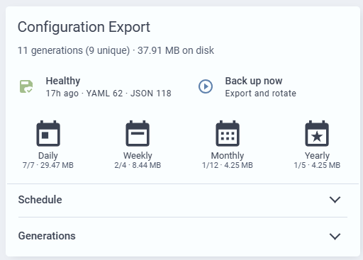

Run it with --check for a diagnostic report, or --report for the JSON inventory the sensor consumes.
Dashboard card
Add via “Add card” → “Manual”. Requires (all HACS): stack-in-card, mushroom, button-card, card-mod, fold-entity-row.
Change the four url_path lines if your share isn’t \\homeassistant\share, and see the browser policy section in the first post to make those buttons clickable.
#  Configuration Export — dashboard card
#  Add via "Add card" -> "Manual".
#  Requires (all HACS): stack-in-card, mushroom, button-card, card-mod,
#  fold-entity-row.
#  Adjust the UNC host in the four url_path lines if your share is not
#  \\homeassistant\share (e.g. use the HA IP address instead). Those buttons
#  need a one-time browser policy to be clickable — see the header comment in
#  config_yaml_export.yaml.

  # --- Status + run button ----------------------------------------------------
  - type: horizontal-stack
    cards:
        entity: sensor.config_export_status
        primary: >-
          {% set s = states('sensor.config_export_status') %} {{ 'Healthy' if s
          == 'ok' else ('Problems' if s == 'error' else 'Never run') }}
        secondary: >-
          {%- set lr = state_attr('sensor.config_export_status','last_run') -%}
          {%- if lr and lr.timestamp is defined -%}
          {%- set d = (now() - (lr.timestamp | as_datetime | as_local)).total_seconds() -%}
          {%- if d < 3600 -%}{%- set ago = (d // 60) | int ~ 'm' -%}
          {%- elif d < 86400 -%}{%- set ago = (d // 3600) | int ~ 'h' -%}
          {%- else -%}{%- set ago = (d // 86400) | int ~ 'd' -%}{%- endif -%}
          {{ ago ~ ' ago · YAML ' ~ (lr.yaml_files | default(0)) ~ ' · JSON '
             ~ (lr.json_files | default(0)) }}
          {%- else -%}Waiting for the first run{%- endif -%}
        multiline_secondary: true
        icon: >-
          'mdi:content-save-check' if s == 'ok'
             else ('mdi:content-save-alert' if s == 'error' else 'mdi:content-save-off') }}
        icon_color: >-
          {% set s = states('sensor.config_export_status') %} {{ 'green' if s ==
          'ok' else ('red' if s == 'error' else 'grey') }}
        tap_action:
          action: more-info
        # Wrap onto a second line instead of truncating with an ellipsis
        card_mod:
          style:
            mushroom-state-info$: |
              .container {
                white-space: normal !important;
                overflow: visible !important;
              .primary, .secondary {
                text-overflow: clip !important;
                line-height: 1.25 !important;
              ha-card { --ha-card-border-width: 0; }
        entity: script.config_export_run_now
        primary: Back up now
        secondary: |-
          {% if is_state('script.config_export_run_now','on') %}
            Running…
          {% else %}
            Export and rotate
          {% endif %}
        icon: >-
          {{ 'mdi:progress-download' if
             else 'mdi:play-circle-outline' }}
        icon_color: >-
          {{ 'orange' if is_state('script.config_export_run_now','on') else
          'blue' }}
        tap_action:
          action: perform-action
          perform_action: script.config_export_run_now
        card_mod:
          style:
              .container {
  # --- Generation tiers: moved up, directly under the status row --------------
  - type: grid
    columns: 4
    square: false
    cards:
      - type: custom:button-card
        icon: mdi:calendar-today
        show_state: false
        show_label: true
        label: |
            const t = entity.attributes.daily || {};
            return `${t.count ?? 0}/${t.keep ?? 0} · ${t.mb ?? 0} MB`;
        tap_action:
          action: url
          url_path: file://homeassistant/share/ha_config_backup/daily/
        hold_action:
          action: more-info
        styles:
          card:
            - padding: 10px 4px
            - border: none
            - background: none
          name:
            - font-size: 13px
          label:
            - font-size: 11px
            - color: var(--secondary-text-color)
          icon:
            - color: var(--state-icon-color)
        icon: mdi:calendar-week
        show_state: false
        show_label: true
        label: |
            const t = entity.attributes.weekly || {};
        tap_action:
          action: url
          url_path: file://homeassistant/share/ha_config_backup/weekly/
        hold_action:
          action: more-info
        styles:
          card:
            - padding: 10px 4px
            - border: none
            - background: none
          name:
            - font-size: 13px
          label:
            - font-size: 11px
        icon: mdi:calendar-month
        show_state: false
        show_label: true
        label: |
            const t = entity.attributes.monthly || {};
        tap_action:
          action: url
          url_path: file://homeassistant/share/ha_config_backup/monthly/
        hold_action:
          action: more-info
        styles:
          card:
            - padding: 10px 4px
            - border: none
            - background: none
          name:
            - font-size: 13px
          label:
            - font-size: 11px
        icon: mdi:calendar-star
        show_state: false
        show_label: true
        label: |
            const t = entity.attributes.yearly || {};
        tap_action:
          action: url
          url_path: file://homeassistant/share/ha_config_backup/yearly/
        hold_action:
          action: more-info
        styles:
          card:
            - padding: 10px 4px
            - border: none
            - background: none
          name:
            - font-size: 13px
          label:
            - font-size: 11px
  # --- Schedule: fold-entity-row, since these rows are interactive ------------
  - type: entities
    show_header_toggle: false
    card_mod:
      style: |
        ha-card {
          box-shadow: none;
          background: transparent;
          padding: 0 !important;
        /* Same 16px inset as the markdown card below, so both rules match */
        #states {
          padding: 0 16px 8px 16px !important;
    entities:
      - type: custom:fold-entity-row
        open: false
        padding: 0
        # Children of a fold row don't inherit the entities card's settings,
        # so state colouring is handed down explicitly.
        group_config:
          state_color: true
        # The rule goes on the fold row itself, not on the section row. The
        # section row sits left of the toggle button, so its own divider stops
        # ~48px short of the edge; this one spans the whole content box and so
        # matches the <details> border-top below exactly.
        card_mod:
          style: |
            :host {
              display: block;
              border-top: 1px solid var(--divider-color);
              padding-top: 12px;
        head:
          type: section
          label: Schedule
          # A section row indents its label 8px and bleeds its divider 16px
          # past the content box. Label goes flush left; divider is dropped in
          # favour of the full-width one above.
          card_mod:
            style: |
              .label {
                margin-left: 0 !important;
                margin-inline-start: 0 !important;
                padding-left: 0 !important;
              .divider {
                display: none !important;
        entities:
          - entity: input_datetime.config_export_time
            name: Daily run time
            icon: mdi:clock-outline
          - entity: automation.config_export_daily
            secondary_info: last-triggered
            state_color: true
  # --- Generations: native <details>, styled to match the Schedule fold -------
  - type: markdown
    card_mod:
      style:
          ha-card {
            box-shadow: none;
          /* Matches #states on the entities card above */
          ha-markdown {
            padding: 0 16px 12px 16px !important;
        ha-markdown$: |
          details {
            padding: 12px 0 0 0;
          /* Match the fold-entity-row header: label left, chevron right */
          summary {
            cursor: pointer;
            margin-left: 0;
            padding-left: 0;
            display: flex;
            align-items: center;
            justify-content: space-between;
            font-size: 15px;
            font-weight: 500;
            color: var(--primary-text-color);
            padding: 4px 0;
            list-style: none;
          summary::-webkit-details-marker {
            display: none;
          summary::marker {
            content: "";
          summary::after {
            content: "";
            width: 9px;
            height: 9px;
            /* Aligns with fold-entity-row's toggle glyph, which sits 12px
               inside its 48px icon button. Nudge this one number if needed. */
            margin-right: 12px;
            border-right: 2.8px solid var(--primary-text-color);
            border-bottom: 2.8px solid var(--primary-text-color);
            transform: rotate(45deg) translate(-2px, -2px);
            transition: transform 180ms ease-in-out;
          details[open] summary::after {
            transform: rotate(-135deg) translate(-2px, -2px);
          /* NOTE: the markdown card strips class= and style= attributes, so
             everything below has to be element/position based. */
          table {
            width: 100%;
            border-collapse: collapse;
            font-size: 13px;
            margin-top: 10px;
          td, th {
            padding: 5px 6px;
            vertical-align: top;
            text-align: left;
          th {
            border-bottom: 1px solid var(--divider-color);
            font-weight: 500;
          /* Kept + Size columns right-aligned */
          th:nth-child(2), th:nth-child(3),
          td:nth-child(2), td:nth-child(3) {
            text-align: right;
            white-space: nowrap;
          /* Tier name */
          td:first-child {
            font-weight: 600;
          /* Share path line: the div that follows the table */
          details > div {
            padding-top: 22px;
            font-size: 12px;
            opacity: 0.8;
    content: |
      {% set s = 'sensor.config_export_status' %}
      <details>
      <summary>Generations</summary>
      <table>
      <tr><th>Tier</th><th>Kept</th><th>Size</th><th>Newest</th></tr>
      {% for label, key in [('Daily','daily'), ('Weekly','weekly'), ('Monthly','monthly'), ('Yearly','yearly')] %}{% set t = state_attr(s, key) or {} %}<tr><td>{{ label }}</td><td>{{ t.get('count', 0) }} / {{ t.get('keep', 0) }}</td><td>{{ t.get('mb', 0) }} MB</td><td><code>{{ t.get('newest', '—') }}</code></td></tr>
      {% endfor %}</table>
      <div>Share path: <code>\\homeassistant\share\ha_config_backup</code></div>
      </details>
Update: selective restore, and the project has moved to GitHub
:package: GitHub - FortranFour/ha-config-export: Generational YAML/JSON config backups for Home Assistant, with .storage converted to YAML and selective restore · GitHub
The code was getting long for forum posts, so it now lives in a repository with proper docs.
Install instructions: docs/INSTALL.md

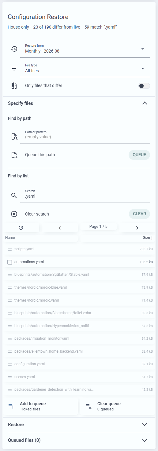

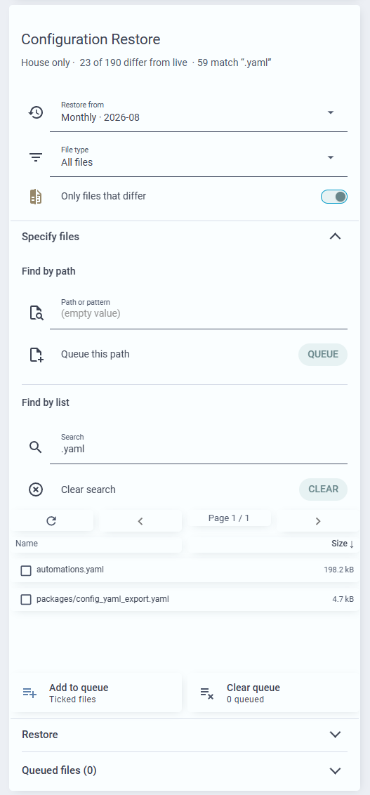

The big addition is restore. Browse any generation, and every candidate file is hashed
against your live copy so the list shows only what actually differs — 3 of 190 differ from
live
is a far better starting point than 190 filenames. Pick files from a paged list with
search and sortable Name/Size columns, or type a path with wildcards. Everything you
overwrite is copied to a timestamped rollback folder first, and an export runs immediately
before any restore.

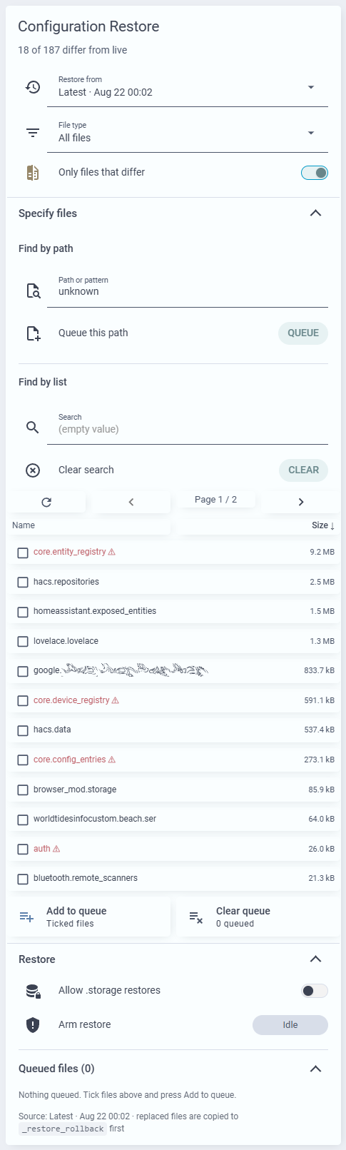

.storage restores are gated separately, since restoring core.entity_registry or auth
from three weeks ago can rename half your entities or lock you out. Those show red with a
warning triangle.
Also since the original posts:
  • Distinct-snapshot count, so a fresh install no longer claims “4 generations” when one export is hardlinked into four tiers
  • YAML vs JSON source counts on the status line
  • Non-JSON files in .storage (certs, keys, pickles) copied verbatim instead of reported as errors
  • Frigate’s config fetched over its add-on API, since /addon_configs is unreachable from the Core container
  • --check diagnostics, and failures can no longer vanish silently
  • Card rebuilt: consistent fold headers, and a chevron that works in the iOS app
If you installed the original, replace all three files — script, package, card — and note the
package gained a couple of new helpers.
Wow, does it support file compression for space savings? Differential only?
Compression yes, differential no — but the numbers end up close to differential anyway.
Compression: each generation is a .tar.gz. Config files are text: my instance is ~190 files that come out around 4.3 MB compressed (vs. ~ 5 GB for full backup without media, i.e. 1000-fold smaller). There’s also an uncompressed latest/ mirror alongside the archives, so you can browse, grep and diff the newest export without extracting anything. Set COMPRESS = False at the top of the script if you’d rather have plain folders throughout.
Differential: no, every generation is a full snapshot. That’s deliberate because a full snapshot restores on its own, with no chain to walk back and nothing that breaks if an intermediate generation is pruned or corrupted. At a few MB per config, the storage argument for differentials doesn’t really apply.
If you’re asking if you can see which files are changed between now (live version) and various states, that’s addressable through the various options for selecting files in the Restore card. Only files that actually differ are worth restoring:
Additionally, every tarball contains a hashed manifest:
Though these files reside on HA, you can browse and view them equivalently in the terminal or on your PC’s desktop:
Where the space saving actually comes from: hardlinks between tiers. Promotion doesn’t copy. When a daily is promoted to weekly, monthly and yearly, all four names point at the same inode. So one snapshot living in four tiers occupies disk once, and a full 28-generation set costs closer to the number of genuinely distinct exports than 28 × 4 MB. The card shows both numbers for that reason: 28 generations (9 unique).
One caveat: hardlinks are a filesystem feature, so they hold on the HA machine’s ext4 but not if you copy the tree to Windows over SMB, there each tier entry becomes a real file. Still only a couple of hundred MB at steady state, but it explains why the PC copy looks bigger than the share. Look in the Extras directory for a Windows script to copy files over to your PC. There’s also a script to encrypt and upload to OnePoint.
If you did want true deduplication across generations, borg or restic pointed at the latest/ mirror would do it properly with block-level dedup and encryption. I went with plain tarballs because they’re readable with no tooling in ten years, which felt like the right trade for config files.

Existing users only need to update:
packages/config_restore.yaml
Copy it to:
/config/packages/config_restore.yaml
Then run Developer Tools → YAML → Check configuration and restart Home Assistant.

Update — optional redaction and encryption
Everything below is optional and off by default. If you update and tick nothing, the export behaves exactly as it did before.
Privacy & encryption
A new section on the export card:
  • Encrypt the backup — AES via cryptography (already ships with Home Assistant), keyed by scrypt from a passphrase. Archives become .tar.gz.enc and show a padlock in the restore picker; restore decrypts in memory, never to a plaintext file in the share.
  • Redact personal info — replaces credential-shaped values with tokens: keys named like password / token / api_key / secret, email addresses, credentials inside URLs such as rtsp://user:pass@camera/stream, and latitude/longitude.
  • Keep sidecar of redacted values — records what was removed to sidecars/, outside the archive, so restore can put the values back automatically. Outside is the point: a sidecar inside the archive would be obfuscation with the key taped to the box.
  • Encrypt the sidecar separately, plus a passphrase box with a show/hide toggle and an indicator showing whether one is stored.
File restoration automatically decrypts and restores redacted info

Update — v1.2.0: old rollbacks and sidecars no longer pile up
Two things in the share used to grow without limit. That is now fixed.
_restore_rollback/ gets a timestamped folder every time you restore a file, holding a copy of whatever was overwritten. Restore a registry a few times and you are keeping several 9 MB copies indefinitely. sidecars/ collects one file per redacted export, and those outlive the generation they belong to, so you end up with sidecars for dailies that aged out weeks ago.
Automatic pruning
Both are now pruned on a deliberately cautious rule: an item is kept while it is either newer than a year or among the twelve most recent. Only when both tests fail does it go.
That means a quiet year of restores keeps everything, and a busy week does not evict last month’s safety net. The rollback folder is the only copy of a file a restore replaced, so I would rather it err toward keeping. Both numbers are constants at the top of the scripts if a year is too long or twelve too few.

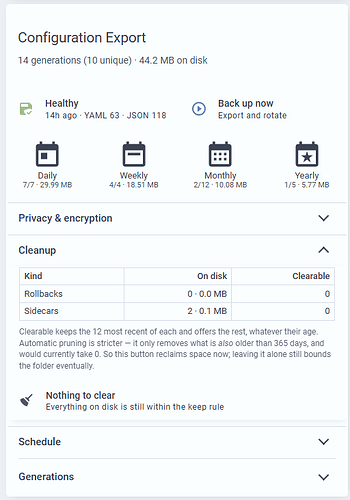

The Cleanup section
New fold on the export card, showing how many rollbacks and sidecars are on disk, how much space they take, and how many could go. One button clears them, behind a confirmation dialog.
It is deliberately more aggressive than the automatic rule — it keeps the twelve most recent regardless of age. Automatic pruning is the unattended backstop, and the button is there when you want the space back today.
An example. Sixteen rollback folders, all a month old: automatic pruning takes none, because none are a year old. The button offers four, keeping the newest twelve.
A notification appears when there is something to clear, and dismisses itself when there is not. Ignoring it is fine — the folder stays bounded either way.
