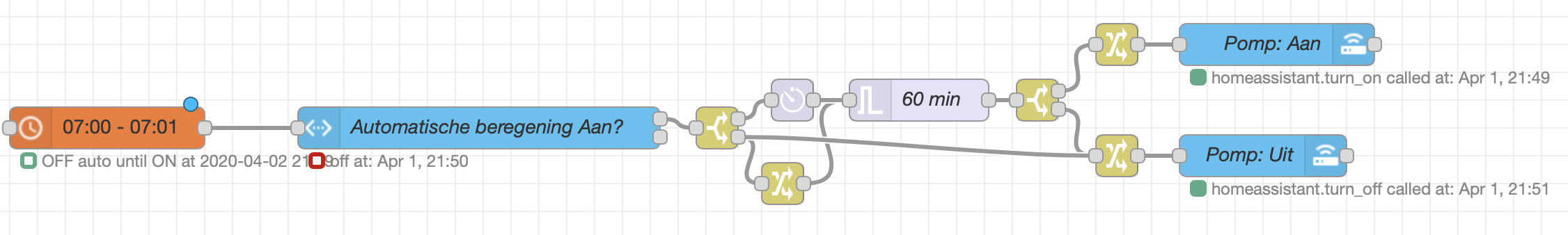

I have build the node below in Home Assistant. Goal is that the irrigation system irrigates the garden automatically between 7 and 8 h AM on specific days. Switching on and off the automatic program is arranged via an input_boolean switch in Home Assistant. I have two questions:
- Is it possible to optimize this flow?
- The override button does not work. When I switch off the switch, this does not trigger the reset function.
Who can help me?
Schedex node (this node is only used as trigger to switch the program on)
- Switch on: 07:00
- Switch off: 07:01
- Days: Mon-Wed-Fri-Sun
Current state node: Automatische beregening aan?
- Entity ID: input_boolean.beregening_switch
- If State: is on
Switch:
- is on --> 1
- is off --> 2
Delay:
- Action: Delay each message
- Fixed delay
- For 250 milliseconds
Change Node: Reset
- Set msg.reset to true
Trigger: 60 min
- Send: true
- Then wait for
- 60 minutes
- Then send false
- Handling: all messages
Switch
- is true --> 1
- is false --> 2
Change Node: Aan
- Set msg.payload
- To: {“option”: “Aan”}
Change Node: Uit
- Set msg.payload
- To: {“option”: “Uit”}
Call Service: Pomp: Aan
- Server: Home Assistant
- Domain: homeassistant
- Service: turn_on
- Entity ID: switch.fibaro_fgs222_beregeningspomp
Call Service: Pomp: Uit
- Service: turn_off
