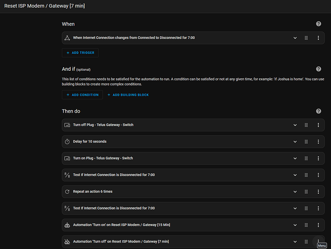

I’m still new to programming the automations.
I tried replicating @CO_4X4’s automation based on the sequence of events.
Hopefully, he can let me know if I’m on the right track.
Below is the YAML as well, if somebody wants the code. If you want, I can upload the code for the 15, & 30 min automations, but I just duplicated this & modified accordingly.
alias: Reset ISP Modem / Gateway [7 min]
description: ""
triggers:
  - trigger: state
    entity_id:
      - binary_sensor.internet_connection
    from: "on"
    to: "off"
    for:
      hours: 0
      minutes: 7
      seconds: 0
conditions: []
actions:
  - type: turn_off
    device_id: c189e22bed5baf82036803190e9f46e8
    entity_id: b6e19b67b1b11cbae83653c3831d1d51
    domain: switch
  - delay:
      hours: 0
      minutes: 0
      seconds: 10
      milliseconds: 0
  - type: turn_on
    domain: switch
  - condition: state
    entity_id: binary_sensor.internet_connection
    state: "off"
    for:
      hours: 0
      minutes: 7
      seconds: 0
  - repeat:
      count: 6
      sequence: []
  - condition: state
    state: "off"
    for:
      hours: 0
      minutes: 7
      seconds: 0
  - action: automation.turn_on
    metadata: {}
    data: {}
      entity_id: automation.15_min
  - action: automation.turn_off
    metadata: {}
      stop_actions: true
      entity_id: automation.reset_isp_modem_gateway
mode: single
Normally just a single reboot is all I need. This will be good after a power outage, or an extended service outage, like what happened to Rogers customers. lol
