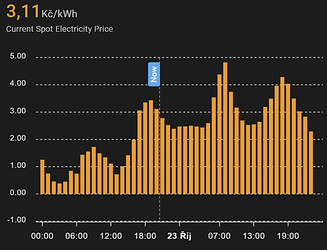

I’m trying to solve this puzzle of aligning spot electricity prices with scheduled car charging. I have an integration that updates a sensor approximately 24 hours in advance with spot electricity prices. Using this data, combined with the current percentage of car battery charge and the set charge limit of the car, I can compute the number of minutes the car should charge in each hour to reach the set limit within a predetermined number of hours.
My primary challenge is setting up a binary switch entity’s schedule in advance. This switch would then control the car charger. Is there a method to schedule the switch in advance with precision down to minutes?
For illustration: If I need to charge 15kWh and with my charging rate of roughly 10kW, it equates to about 1 hour and 30 minutes of charging. As electricity prices vary throughout the day, with the most economical prices between 4 am to 5 am, and the next best from 1 am to 2 am. Given this, I need a schedule that turns on the charger from 1:00 am to 1:30 am and then from 4:00 am to 5:00 am. This plan has to be recalculated each time the car connects to the home charger (I can detect this).
Any ideas on how to approach switch scheduling within Home Assistant?
