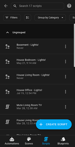

I’ve definitely got scripts that are being run when I say the name of the script using voice assistant. My assumption was that the voice assistant was looking for a matching script name and executing it. Below is a screenshot of the scripts I’ve been using. I was hoping to have a single script called “Lights!” that would automatically select all the lighting devices in the same zone that the voice assistant device that hears the command is located as the target, then execute the script.
