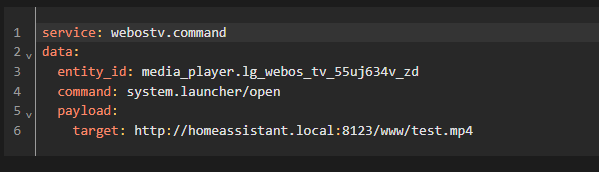

Do you mean something like this? That is, I fill in the automation: Condition, additional condition and already the action that needs to be performed?
www needs to be local
  entity_id: media_player.xxxxxxxxx
  command: system.launcher/open
  payload:
    target: http://192.168.1.xxx:8123/local/test.mp4

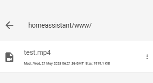

Create a folder under homeassistant called www and put the video in there.
www=local Then reference the file using local.

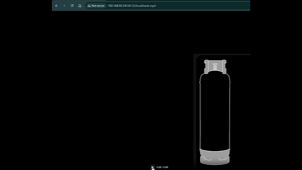

Such a folder was already created on May 21, I tried to do it, but it didn’t work, can I somehow check the access and functionality of this link? It should open in the browser on the computer, or am I wrong? http://192.168.1xxx:8123/local/test.mp4 does not work unfortunately, I can’t open the video in the browser on the computer
No you are right, that should work.

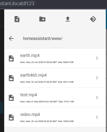

Download the 640x360 or the 1280x720 sample file from here by right clicking when it plays. Select save video…
Name it earth.mp4
Upload it to your www folder and test http://192.168.1.xxx/local/earth.mp4
Same error, maybe it’s a matter of access or something? If there was something wrong with the video, would the site give a 404 not found error?
