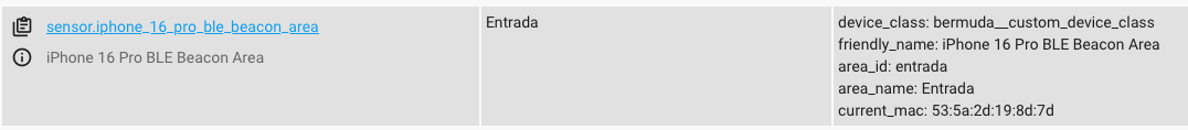

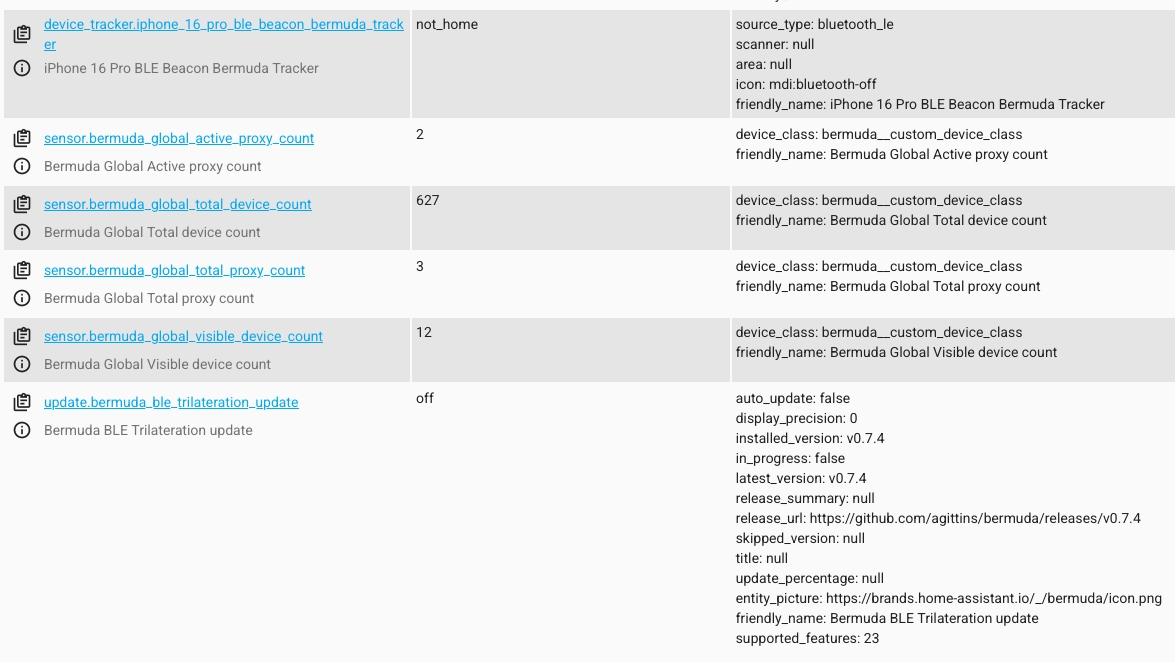

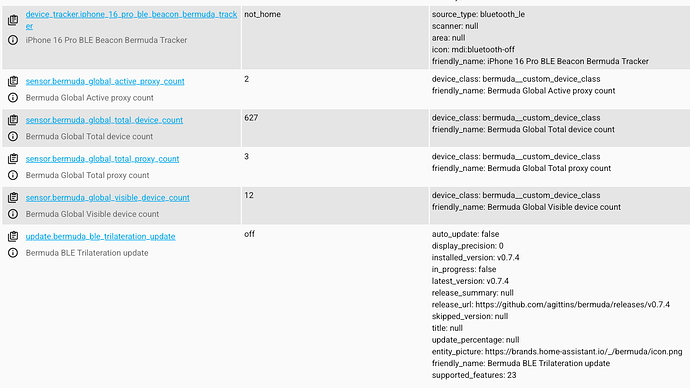

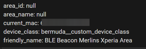

Can you send a screenshot of what your Bermuda sensor looks like in Developer tools?
What does it say under device class? It looks like this for me:
@doktormerlin These are all the attributes in every Bermuda sensor created. Thanks for helping!

This is the only sensor I have with both area_id and device_class: bermuda__custom_device_class
But I still get No matching entities found on “Bluetooth Beacon” drop-down menu when trying to set up your Automation. Thanks for looking into this…
