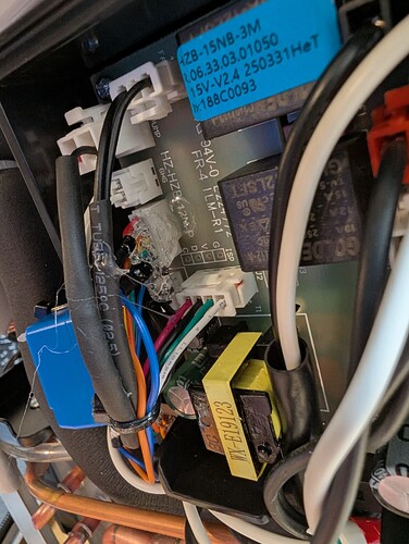

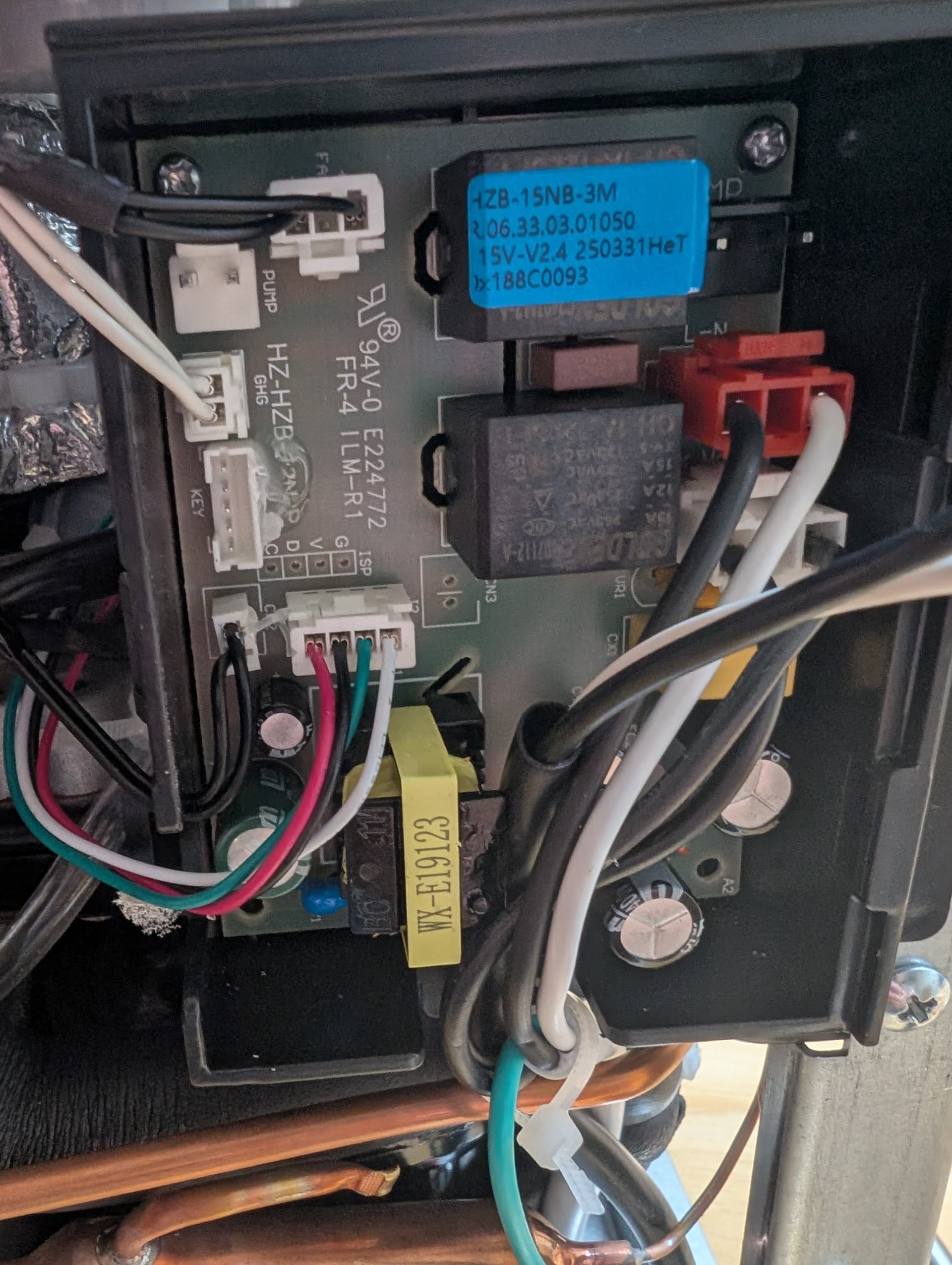

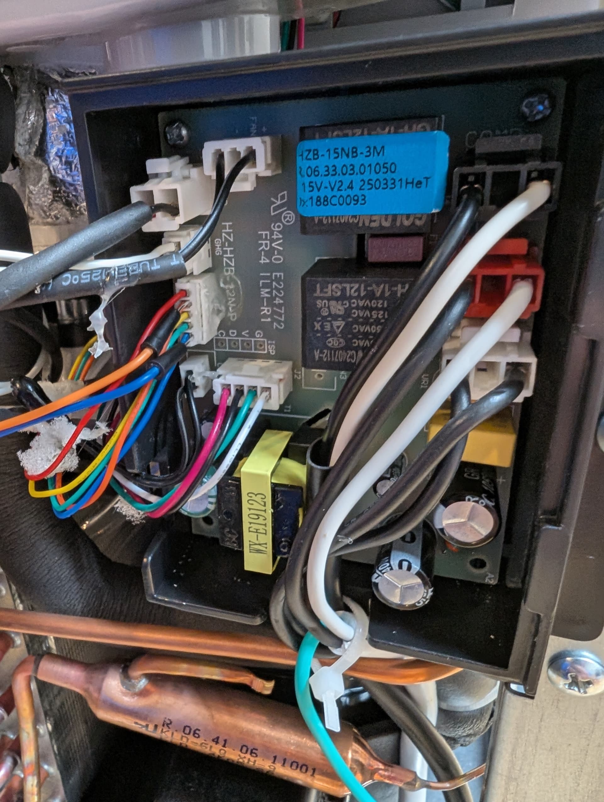

Controller

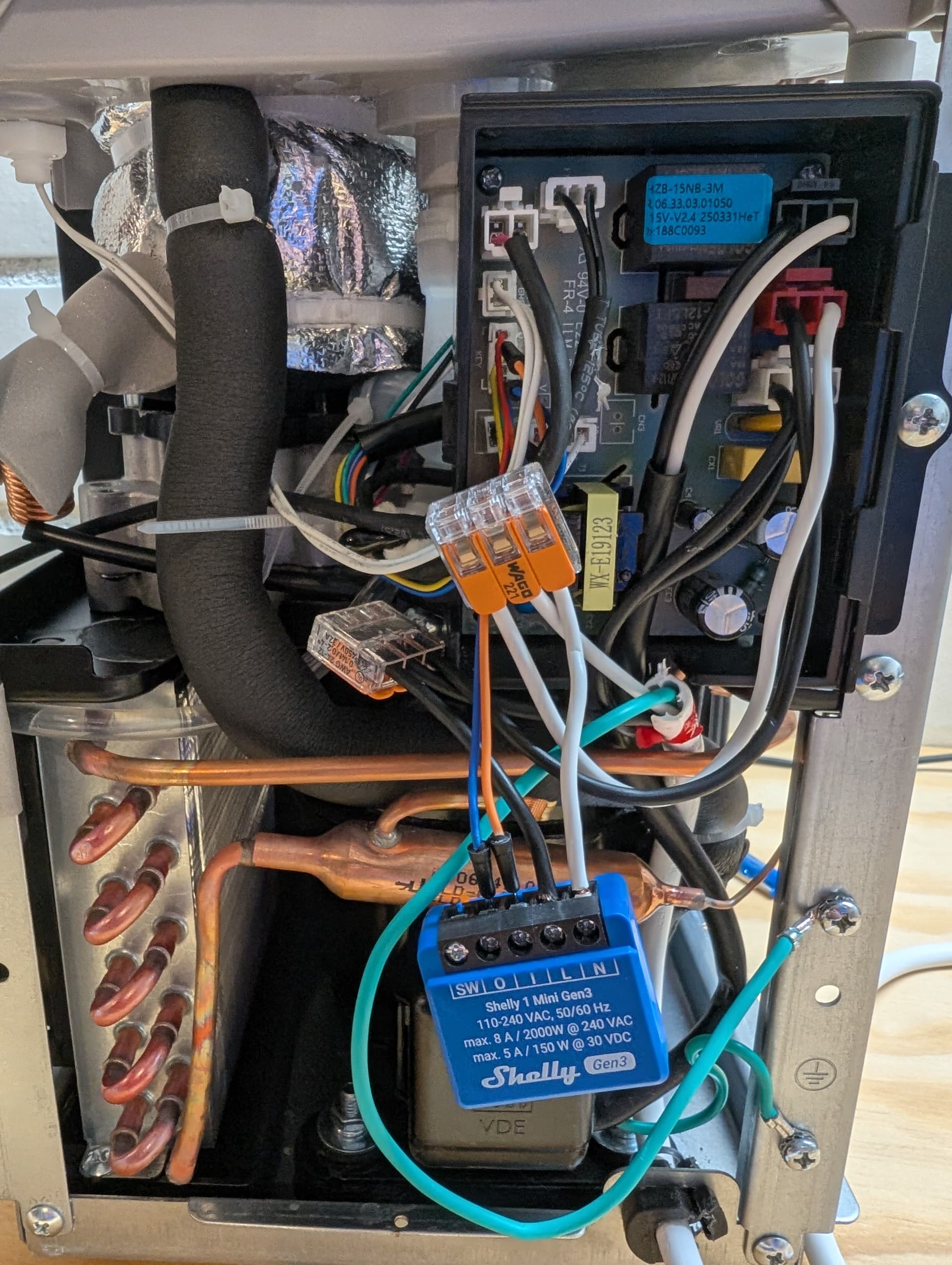

Adding my orange and blue wires for Shelly to toggle the button
connecting Shelly to 120v with wagos
Hot gluing the button wires and my jumpers into place as well as securing the Shelly1 mini.

So how well has this setup worked for you? And how easy was it to find which wires you needed to hook the Shelly up to?
It works pretty well. I can’t track the state to see if it is on or off but it has only caused an issues a couple times.
finding the wires is pretty easy. I just ran jumpers until the machine turned on.
