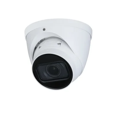

- Additionally I’m planning to install SONOFF GK-200MP2-B - Wi-Fi Wireless IP Security Camera mounted outside but integrated to HA. (I found them on a youtube video today)
