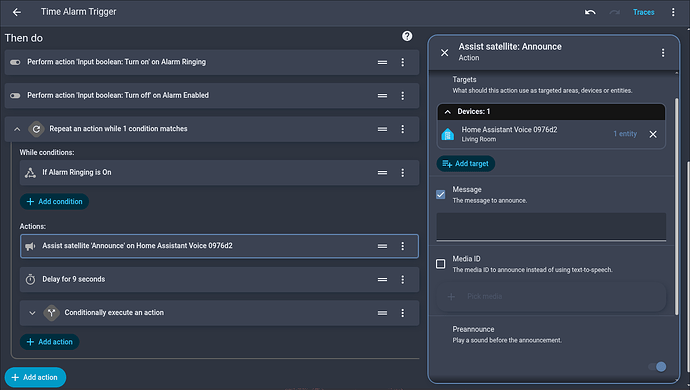

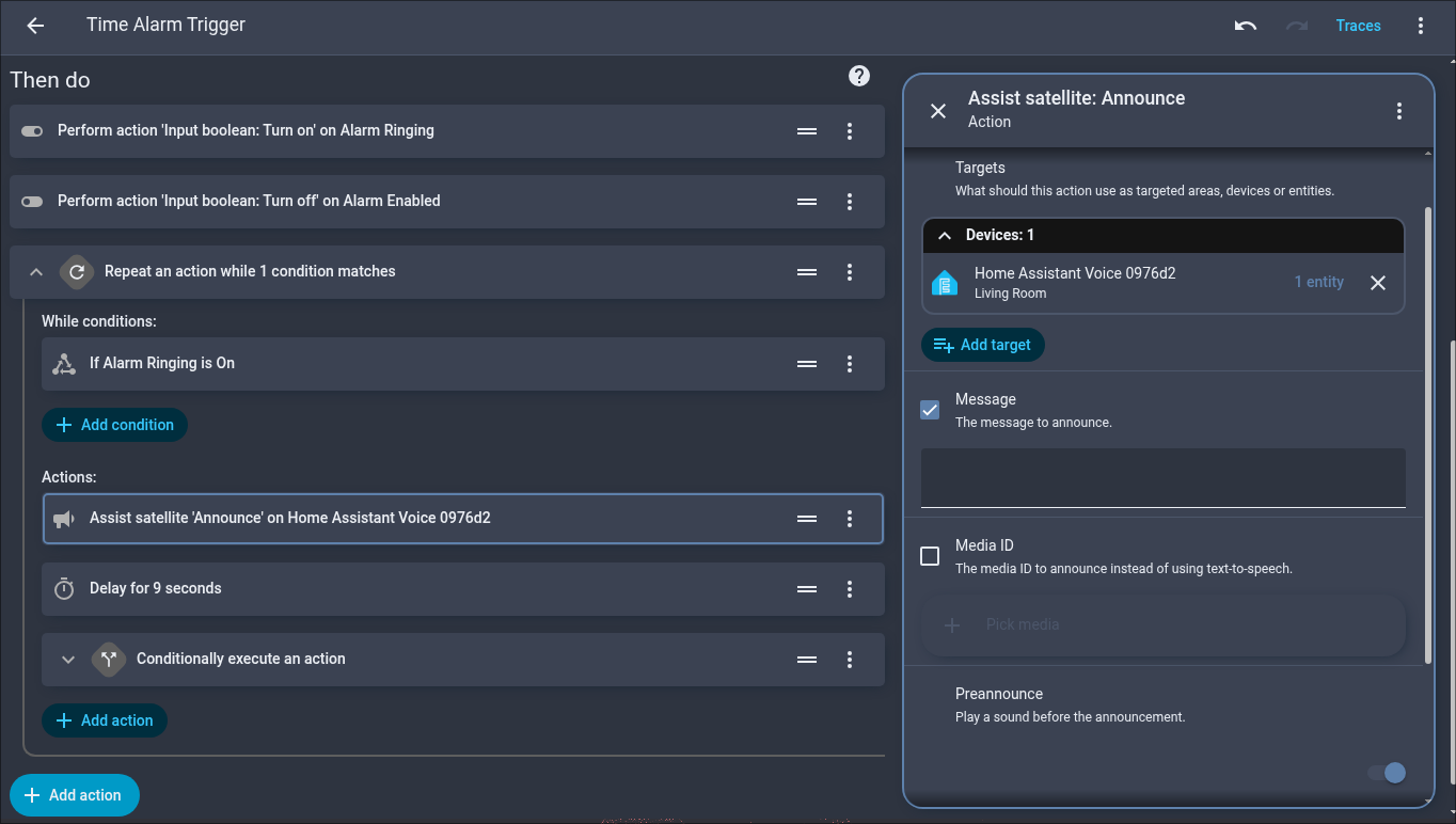

I accidentally found a work around that I’m very happy with. Set an announcement with a blank space in the message and enable the pre-announce chime and have it repeat every 9 seconds or so (whatever’s long enough so that you can interrupt it and tell it to stop). I like this better than the native timer’s chime since it doesn’t allow you to interrupt and stop it like this automation does.
