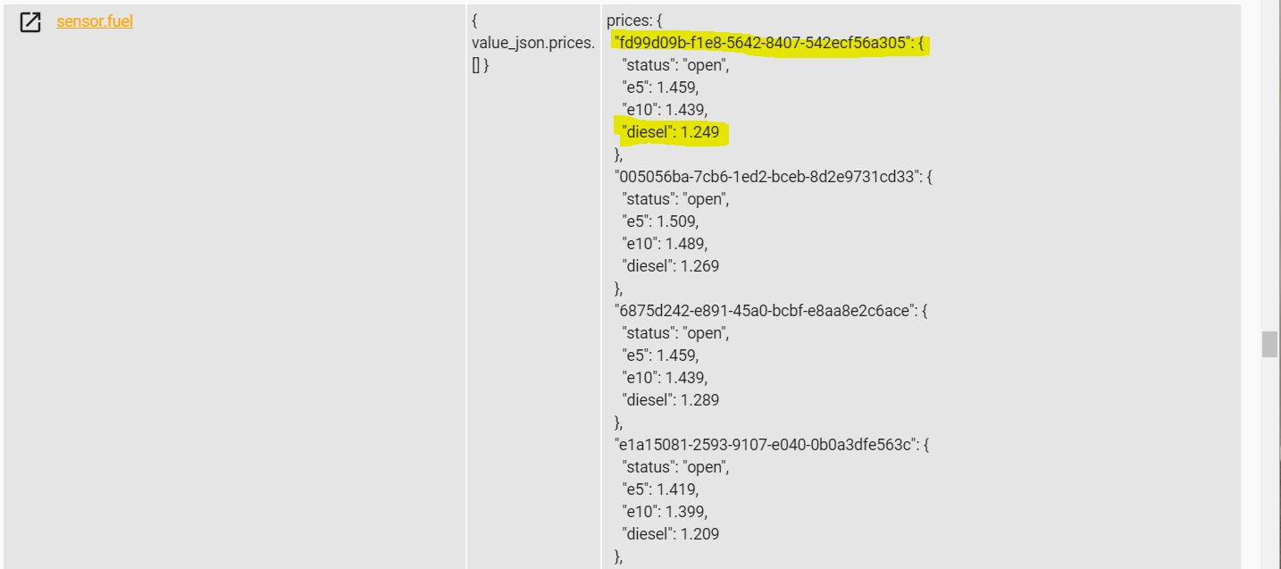

Hey,
how can I use the value diesel 1.249 in automation script?
sensor.fuel[prices]['fd99d09b-f1e8-5642-8407-542ecf56a305.diesel']
try
sensor.fuel[0]['prices']['fd99d09b-f1e8-5642-8407-542ecf56a305.diesel']

the automation does not work and
in the template editor I get this error:
Error rendering template: UndefinedError: homeassistant.core.State object has no element 0
{{ states.sensor.fuel.attributes['prices']['fd99d09b-f1e8-5642-8407-542ecf56a305.diesel'] }}
ne error and no display in the editor, I try the automation
edit: automation did not work
what about
{{ states.sensor.fuel.attributes.prices }}
If this returns a string (That appears to be json), then you’ll need to parse the string to retrieve your information.
it returns:
{‘fd99d09b-f1e8-5642-8407-542ecf56a305’: {‘status’: ‘open’, ‘e5’: 1.419, ‘e10’: 1.399, ‘diesel’: 1.209}, ‘6875d242-e891-45a0-bcbf-e8aa8e2c6ace’: {‘status’: ‘open’, ‘e5’: 1.459, ‘e10’: 1.439, ‘diesel’: 1.259}, ‘e1a15081-2593-9107-e040-0b0a3dfe563c’: {‘status’: ‘open’, ‘e5’: 1.419, ‘e10’: 1.399, ‘diesel’: 1.209}, ‘51d4b655-a095-1aa0-e100-80009459e03a’: {‘status’: ‘open’, ‘e5’: 1.419, ‘e10’: 1.399, ‘diesel’: 1.209}, ‘005056ba-7cb6-1ed2-bceb-8d2e9731cd33’: {‘status’: ‘open’, ‘e5’: 1.469, ‘e10’: 1.449, ‘diesel’: 1.269}}
I have the solution:
{{ states.sensor.fuel.attributes.prices[“fd99d09b-f1e8-5642-8407-542ecf56a305”].diesel }}
