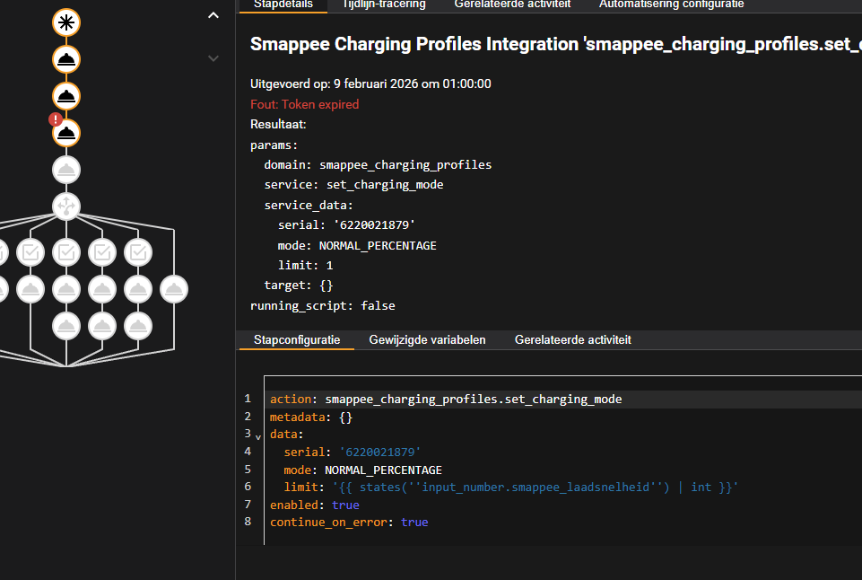

Hi, i have a automation that from time to time get’s an error
I thought i could fix it with ‘continue_on_error’ but it keeps stopping…
Any idea how to fix this?
This step is not that important so i can skip it if needed…
Is it a third party integration providing that action?
Yes it is…
Then that integration needs to be updated. Open an issue in the github repository of the integration.

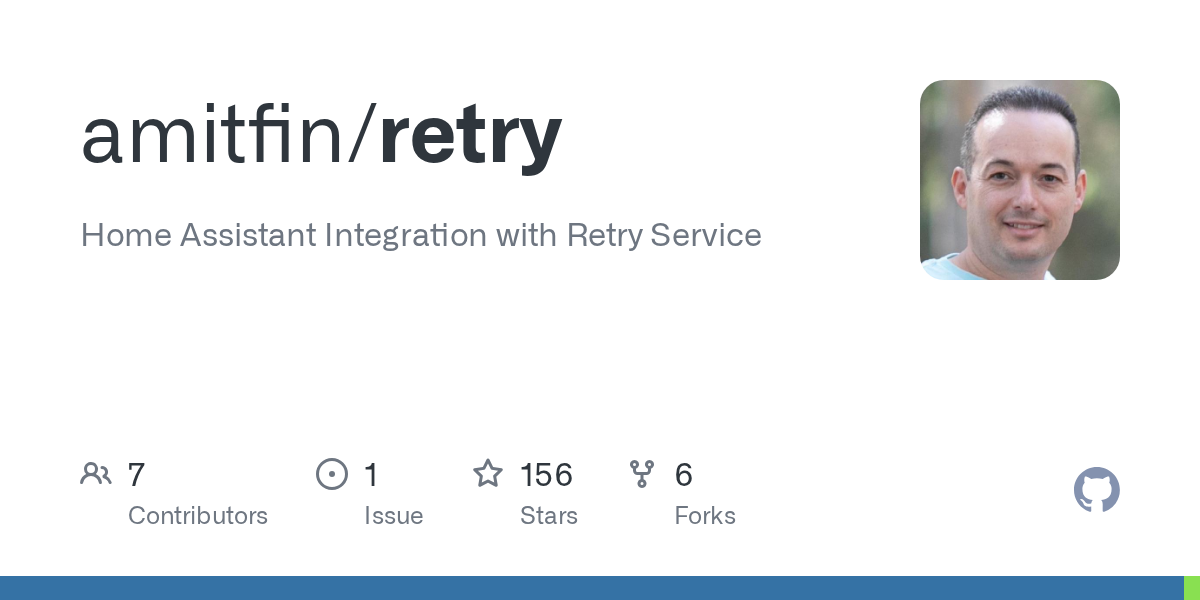

I use the custom retry integration for actions that don’t always work the first time, but will on subsequent calls.
Also, I believe it honors continue_on_error, so this could probably be used as a work-around.
